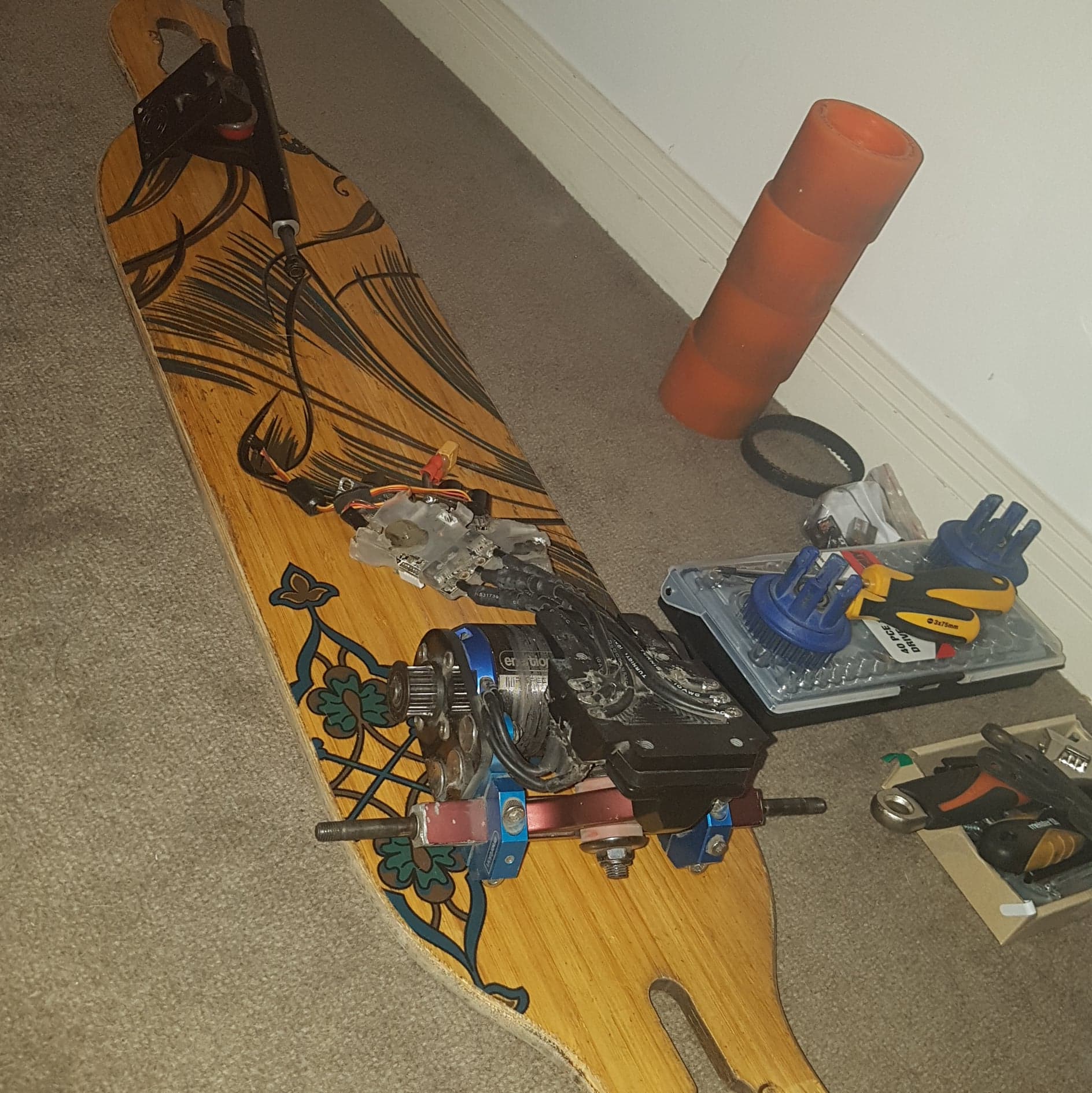

Hey guys, I’m totally new to this DIY esk8 thing. Here is my list, might need some advise from you guys on my build :stuck_out_tongue:
  1. Loaded Dervish FLEX 2
  2. 10s3p Samsung 30Q 40A from their latest board W2
  3. ESC and Battery enclosure of W2
  4. mini-remote 2.4ghz from banggood
  5. vesc 4.12 x2
  6. 6355 RSPEC 190kv motors from enertion x2
  7. Calibre 44 trucks
  8. Anti-spark switch from mboard
Is my battery compatible with my board?53552201_293763107963390_3600299800941035520_n
yes why wouldn’t it :stuck_out_tongue:
edit: Wait you got dual 6355 on standard calibers?
yup, the truck is shaved to fit the pulley
All should work without problems. Make sure to setup correctly your escs & remote & motors But don’t get the antispark, make a simple & reliable xt90s loop key
You might run into some clearance issues with the 44deg baseplate on a drop through deck with the motors mounted towards the middle of the deck. You defo have the right idea with the split enclosure though. Either way, I think you’ll be able to find a way to make it work. :grinning:
Haha, I think I do have an idea what I’m doing :joy:. I’m using an angle riser pad with20190305_081834 Unik riser. I should have enough clearance from the board.
Is the loop key better?
Yes. 100 times yes
I love my loopkey. Never failed on me. Anti spark switches are 1. expensive and 2. prone to fail.
In my opinion they’re just a hassle and waste of money.
