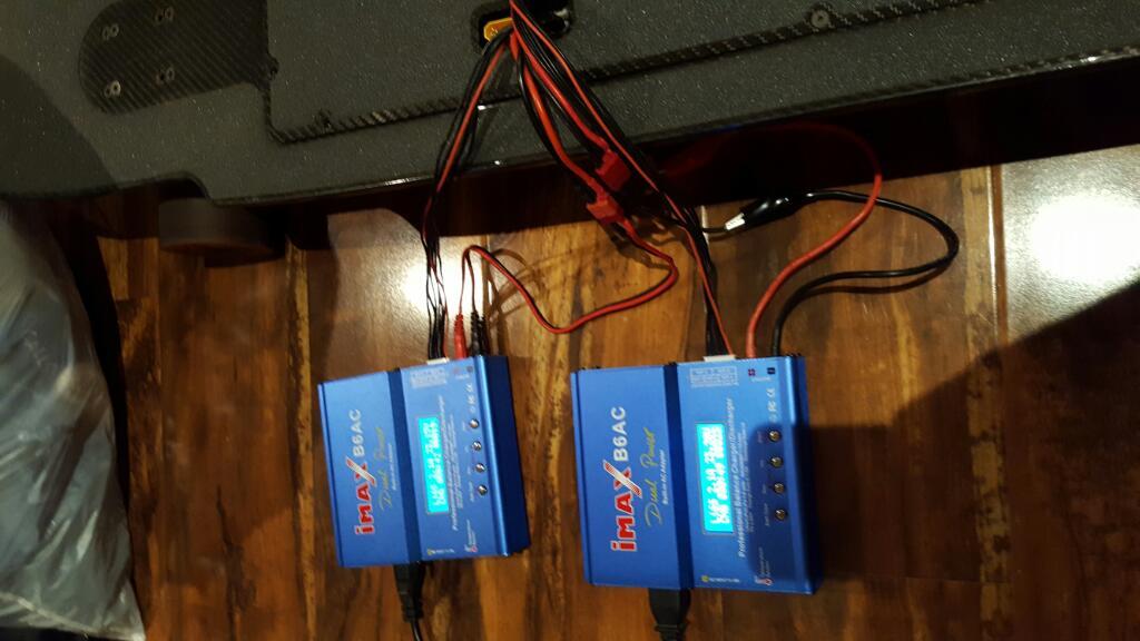

Nice ride. I like how you made good use of the old power switch hole. Is that for an XT90s loop key and charging through the balance ports, so you don’t have to take the lid off?
i have a backpack like that. it basically has velcro straps on the back that let you cinch your board down and the griptape keeps it up
You got it.
How do you charge 12S without BMS or really expensive and rare 12S chargers?
@lowGuido Do you have the main charging leads spliced into the + & - balance leads?

Thanks, man. Best wordless answer ever. :+1::smiley:
