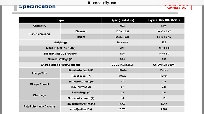

Looking at the 12S2P specs it’s made with Samsung 30Q cells which doing some research I found to have a 15a continuous discharge and a 1.5a standard charge rate and 4.0a max charge.
15 x 2 = 30a continuous
1.5 x 2 = 3a battery min or 4.0 x 2 = 8a battery min
