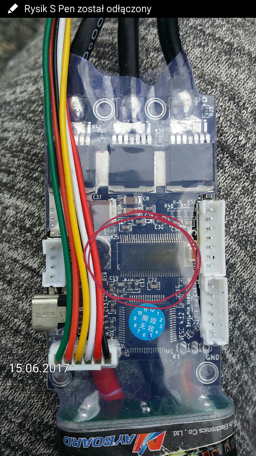

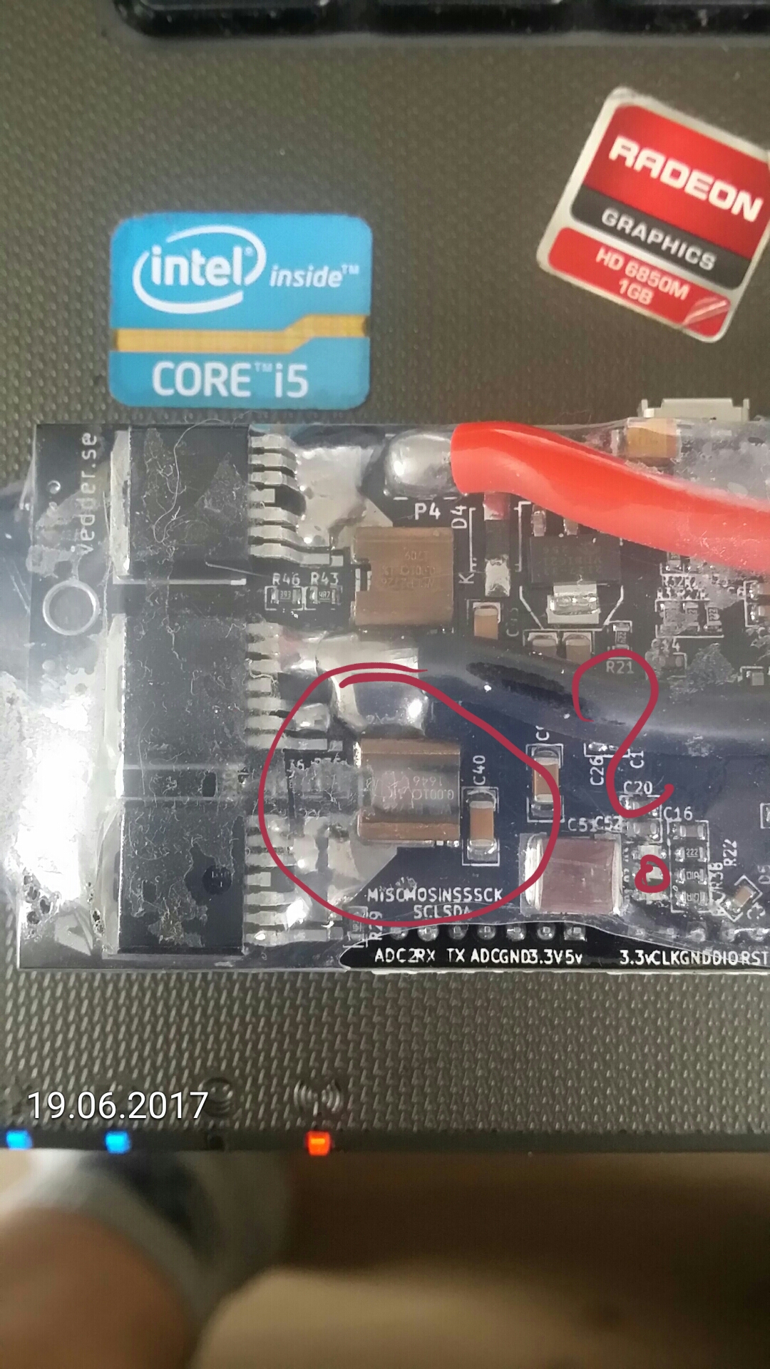

I decided to give you some more photos of my case. On both of my vescs I can see mosfets are burnt. But something that bothers me more is a quality of soldering on them…but, I think that “fighting” with Maytech is pointless anyway I will be very glad if you will give any advices about that
I was informed once again by Maytech that this situation was completely my fault but I need some guidance. According to that please let me know about any of your ideas dear Esk8 community! :slight_smile:
One more thing, I was asked about basic parameters of my vesc, and I sent that my maximum input voltage was changed to 50,4V (4,2Vx12) but this value was not reached anyway, but in case IF IT WILL BE then it should affect braking with fully charged battery only, right?
Hey! Sorry, i missed your post, just seen it. First thing I would do is take that heat shrink off of the VESC because on the pictures it is hard to tell what is dirty and what is burnt. The shunt looks like it got pretty damn hot but that should not matter so much, measure its resistance and if it is the same as the other one (you most probably dont have accurate enough meter to measure 5mOhms precisely so measuring both and comparing is better). Also the mosfet you circled on one of the photos got hot too… measure it if its shorted… the one will most robably have to be replaced. Also dont forget to measure the gate resistors (can be found in schematic on github) because those usually blow with the mosfets.
