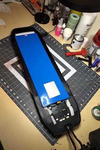

The classic 2 battery enclosure provides ample room for larger batteries and I think I’ve maxed that out with this build. I was going to cycle the stock 378Wh battery until it died, the replace with a new larger 36v system from https://chibatterysystems.com/ until I came across this 12S battery, FOR FREE!. So, my plans changed. I’m going to jamb this massive battery into the Classis 2 and call it the Classic 2.1.
The Meepo hubs won’t take 12s, so I had to get new 600W units from Backfire. The Meepo ESC won’t take 12s, so I bought a Focbox. The rest is spit and polish.

The stock battery is 378Wh, 36V, with a max discharge of 24A. The new battery will be 639Wh, 44.4V with a max discharge north of 30A (specs are unsure). I will set the max discharge to 30A on the focbox.The battery I’ll be using was free because it was broken. The issue presented like a loose wire so I connected the charger and moved the battery around and watched for the charging light to change colour, red meaning the loop was closed and the battery was charging, green meaning the loop had opened tricking the charger into thinking the charging cycle was over. Through trial and error, I narrowed the break down to a nickel strip, which had almost torn through. A bit of solder and it was fixed.
I wrapped the battery in vinyl and did a poor job of it. New battery weight is 2820g which is 1119g more than the original.

At first glance the enclosure had some holes that needed some sealing up. There was no sealant around the motor wires and holes in what I assume were meant to be light bars. Some dust had gotten inside, nothing major though. Inside the enclosure I didn’t need to do much but shave off a few bits of plastic to accommodate the longer battery. The plastic enclosure “lid” needed to be cut to accommodate the thicker battery and focbox and the corresponding cuts made in the foam gasket.
