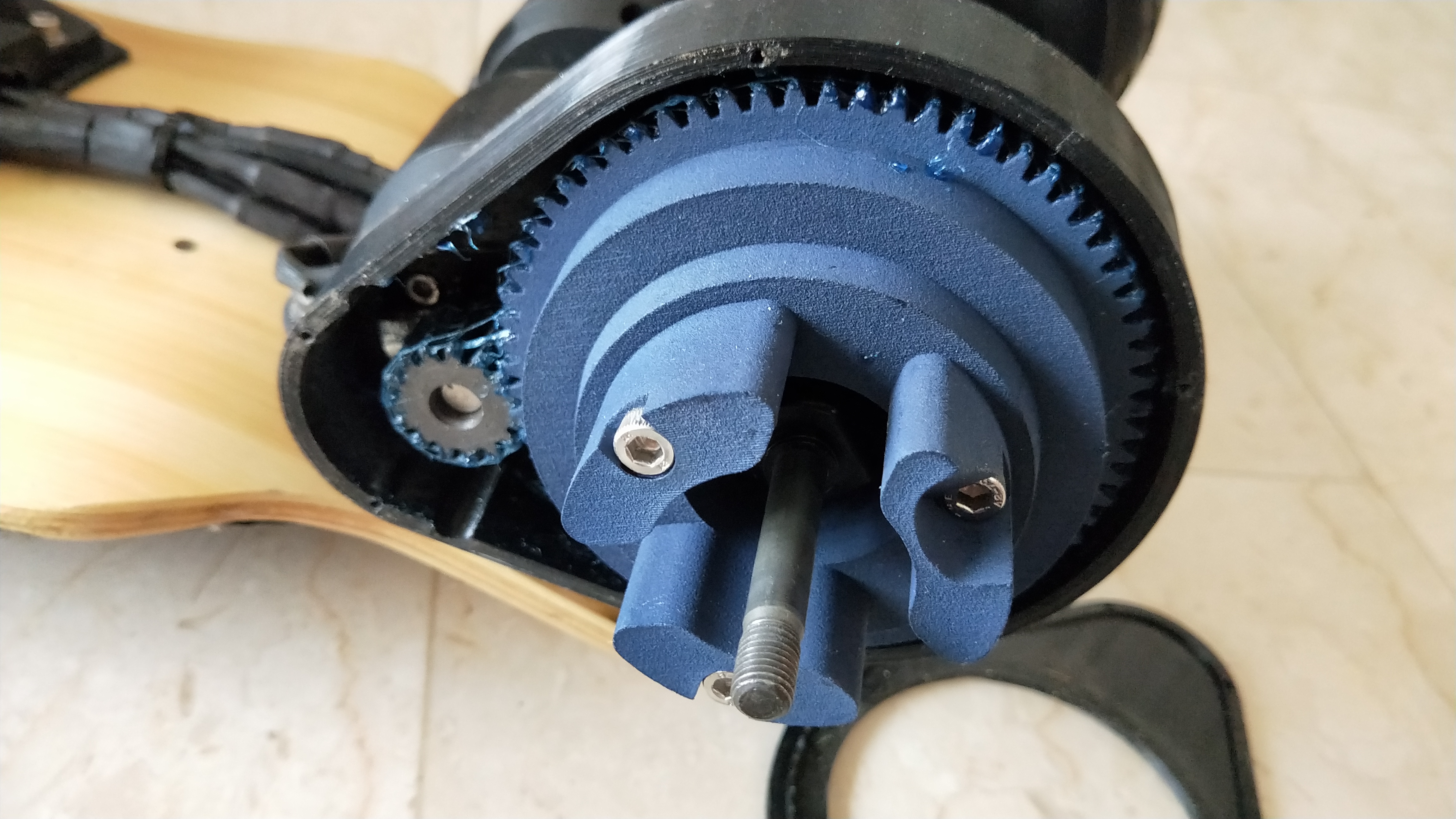

Great build and inspirational for me as i’m currently planning a mini mountainboard for my 10 yo. Don’t mean to preach to the converted but have you correctly meshed your gears? Over tight gear mesh will cause drag and can blow the vesc.

Good advice about the meshing. My gears have some backlash provided for, definitely not too tightly meshed. This is my 4th DIY geared drive (everything from single drive 90mms to dual drive 8") so it’s definitely not the gears.
Also the noise when they are improperly meshed especially when too tightly is very loud, you will know it immediately.

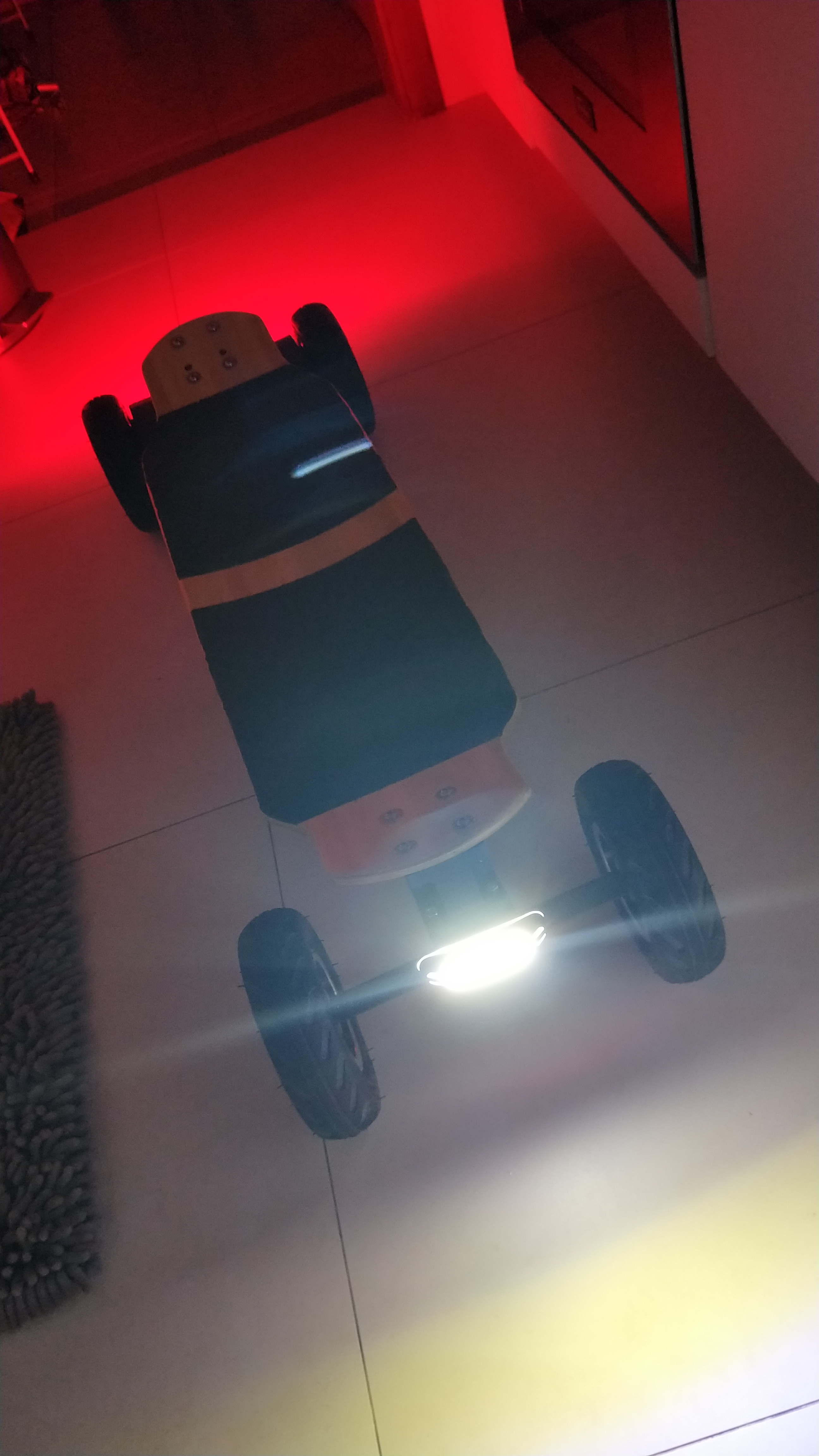

Let there be light!!
Incidentally light allows for board to stand upright…

first of all, love your work. Great design concept with the gear drive using 3D printed parts.
I really hope you can share the files when you have completed the testing!

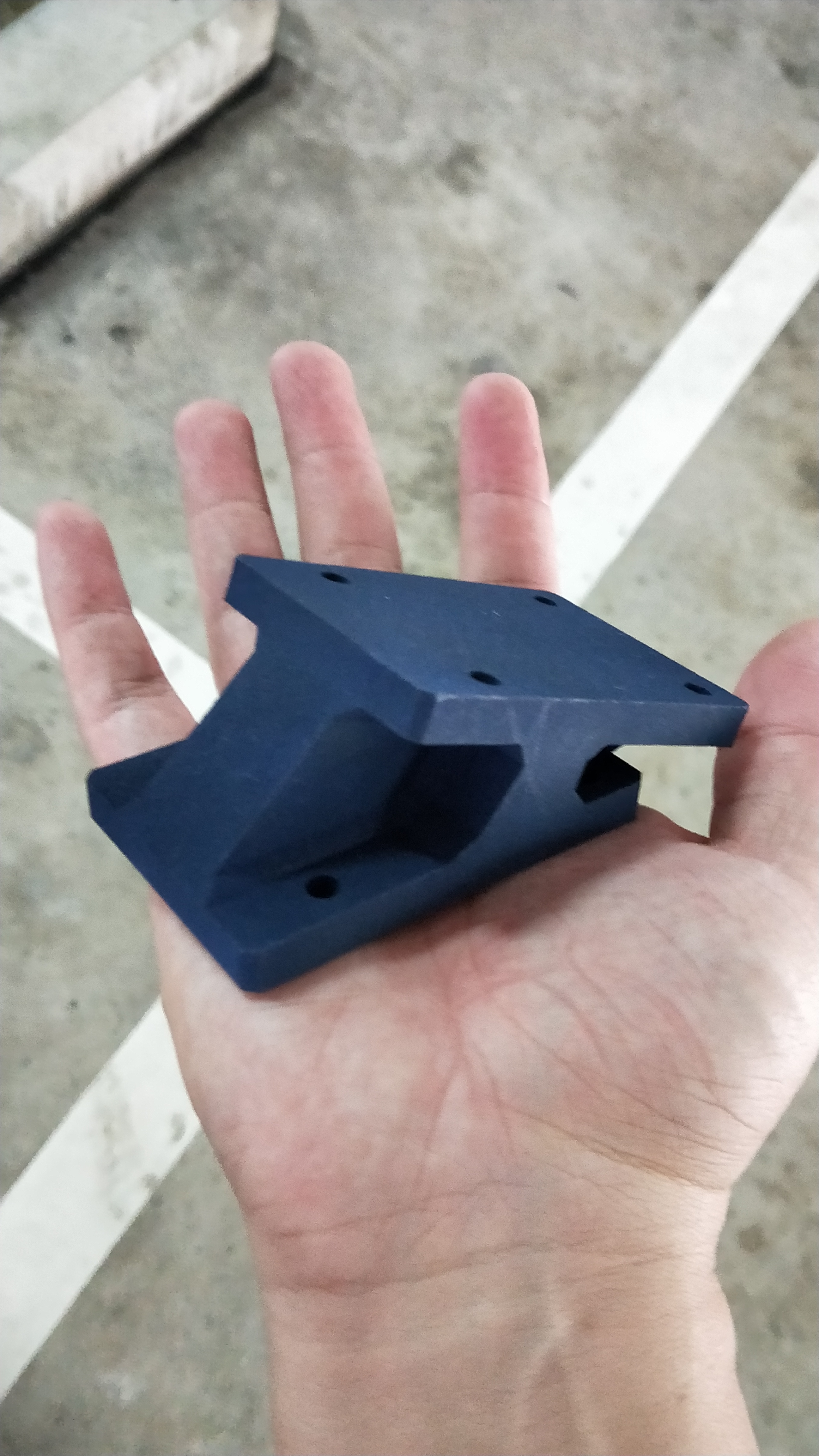

Just wondering what the minimum distance from the centre of the truck to the centre of the motor mount is to see what other motor mounts would work with your design? Such as the well priced @dickyho mounts.
I assume as the mounts are quite short they wouldn’t work pointing out the back to the board?

Hi there, unfortunately I am not in town so I can’t measure it.
I actually wanted the mounts to point inwards in this case to keep them out of sight. I think it might be possible to point backwards but I am not 100% sure.

no worries. Are you able to give it a measure when you are back. Just want to see if the cheaper mounts could work.
I can understand why you wanted them to point inward as it does keep them out of site. I’ll have to do some of my own testing once I have the measurements to see if they will work outward as it gives a bit more room for batteries and if possible get the motors a bit further away from the ground.

It’s a tricky balance, if your motor is mounted further from the axle you will need a much bigger gear which changes your gearing ratio but also makes it closer to the ground too.
Upgraded to HP fusion jet prints… Can’t wait to give it a good test ride!!
