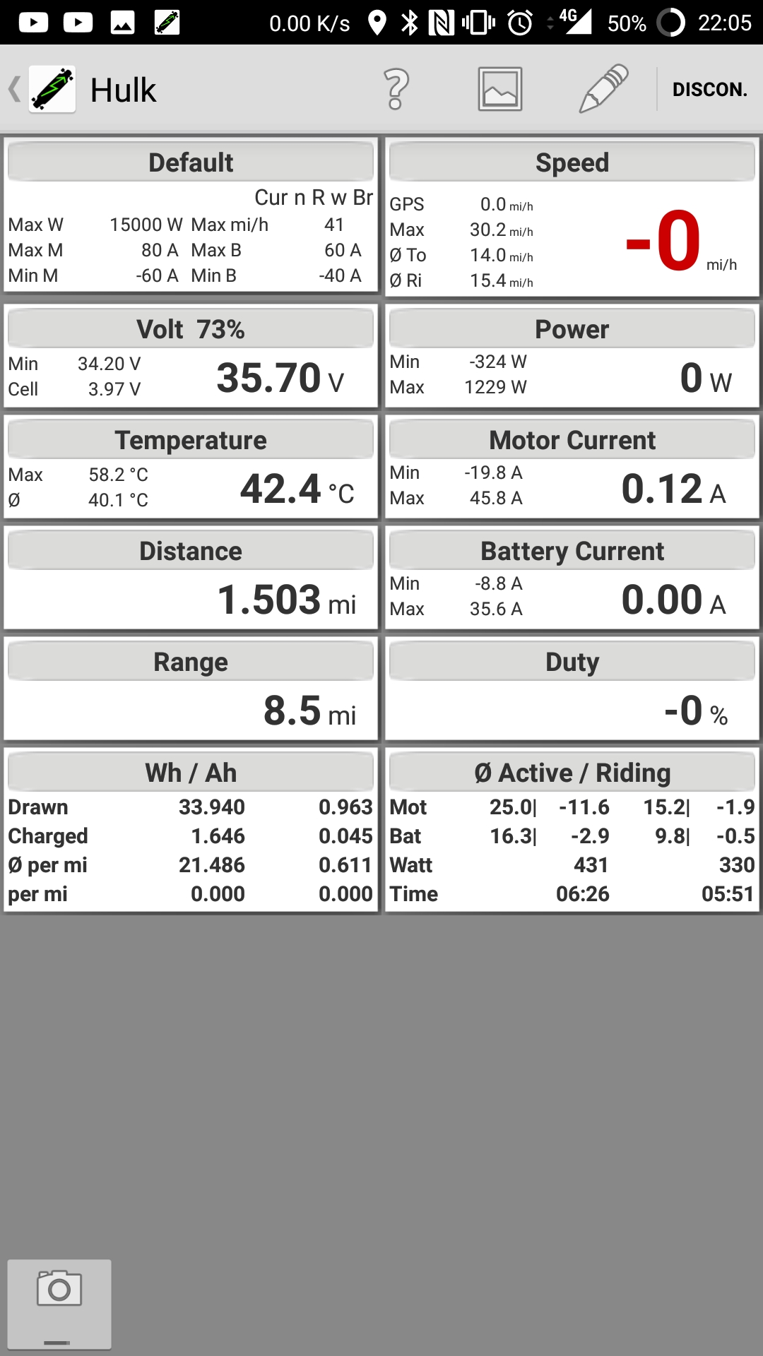

Ok let’s analyse your ride a bit and bring some light to the the continuous amps we use.
On the left side marked in red it shows the average amps when when the battery is really used. So when you just coast (no throttle and no brake) it won’t be counted. In this case you used 16A of your battery.
But the more realistic value is the one on the right. It shows the average amp use while you are moving. So also coasting is taken into account. And in this case you only draw 9.8A from your battery on average.
So instead of 60A continuous (guessed you have 20A Li-ion cells x 3P) you only used 1/6 of that (17%).
So they won’t get hot and they will perform much better than 60% capacity left after 250 cycles. And you won’t discharge them completely which gives you more lifetime and mostly you won’t charge it with a standard charger to exactly 4.2V a cell. In most cases it is a bit lower (like 4.16 a cell) which gives you also more lifetime.

So even at 60% max cont. discharge (which I’d imagine is a cautious number) I’d still have enough amps on a 12S8P pack. Moreso if I stick to a 4.1V-3.6V range.
