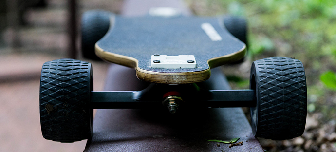

Hey @Komamtb this looks like a great idea! Is that a picture of your build?

Hey there, yes, this one is mine, the biggest problem with this board as far as I can see is only the battery, this thing, for being only 700w of power goes really good, you can not put a VESC i think, for a hub motors, only for normal ones. With a good battery of more than 300wh, new trucks and bearings, on a good day this thing would be amazing.
