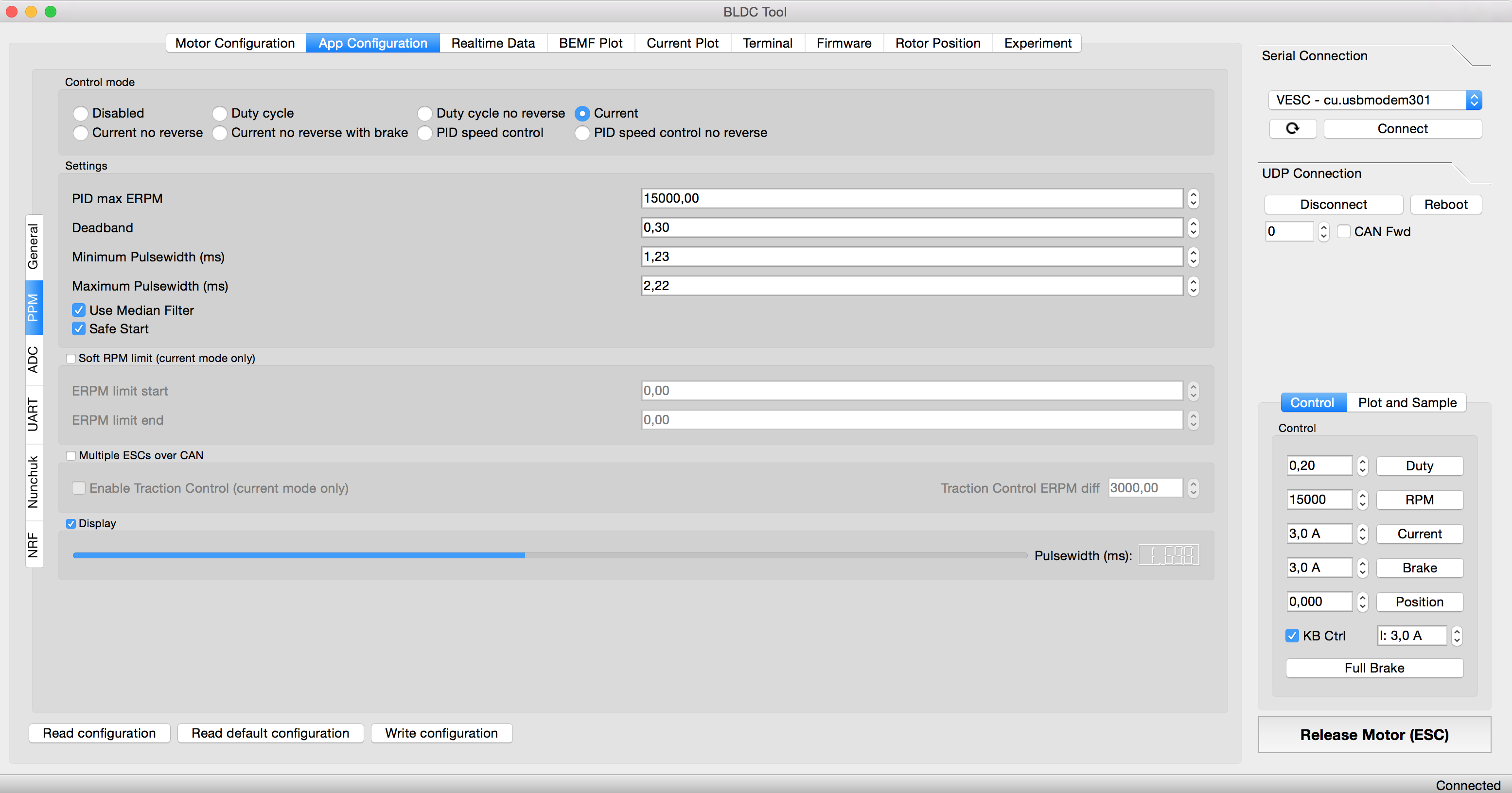

Motor max 80 Motor min -40 Batt max 40 Batt min -15

Ok i put BR ERPM to 60000,00.
