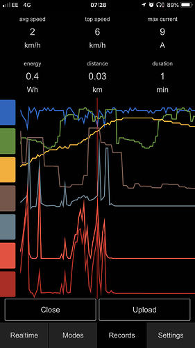

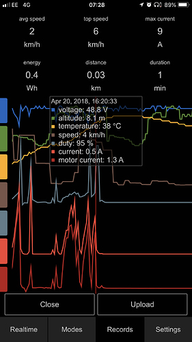

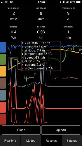

12s Lipo, 4.12 VESC, 190kv dark matter running unsensored (detection wont work in sensored mode) latest Vedder firmware. On steep hills at sub 10kmh when I pull the throttle hard the motor cuts out… any ideas? The VESC is not showing a fault on metr but the graph shows the duty shooting up to 95% at the moment of cutout and the amps die away… at higher speed there’s no problem with tons of power.

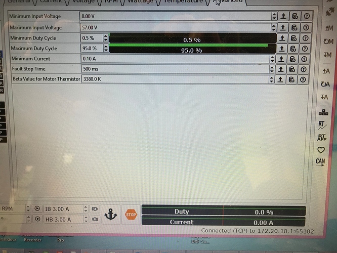

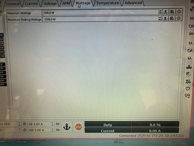

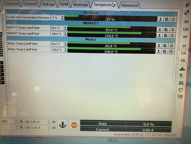

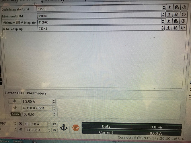

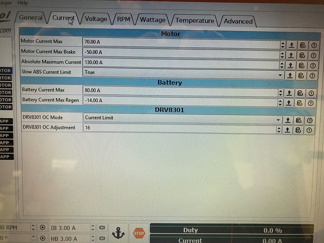

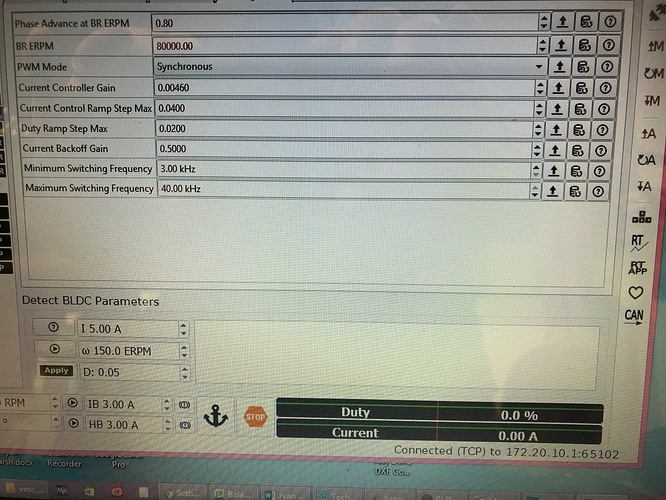

Below are the settings I was using… I say was because I tested the board again last night on a slight gradient, pulled the throttle and it cut out and reset, tried one more time and the VESC died! The VESC still connects to my pc through TCP bridge so I’ve screen shot the settings…

Hopefully someone can help you with this. To my eyes the settings look ok but I’m beginner level when it comes to vector setup… Surely someone has some idea?
isn’t default switching value 20khz instead of 40?
Try these settings:
Motor Max 50 Motor Min -50 Batt Max 30 Batt Min -14

I thought that because the recorded currents in metr were nowhere near my max values I was in the clear but it would seem not!

@onepunchboard I have no idea what the default usually is but that is the figure that came up in the latest VESCtools…
