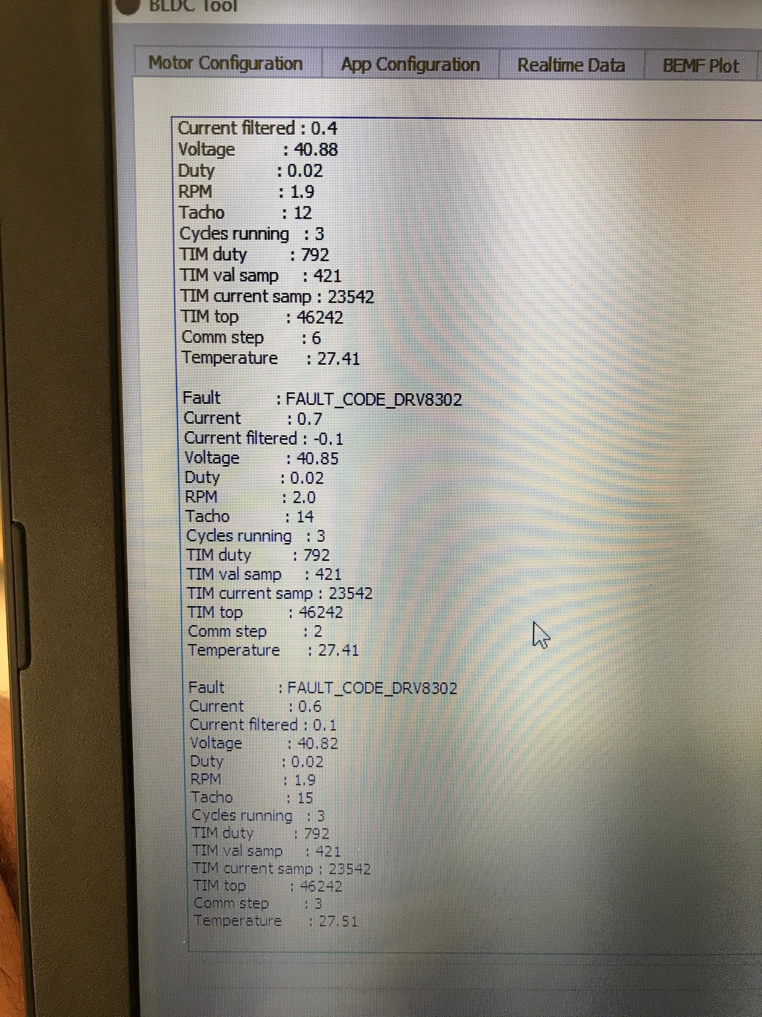

Hello there. I ride my skateboard for a day after that was doing a rare noise but I didn’t give so much importance. Next day I Turn it on it star flashing the red light on the vesc when I press the trigger on the remote. when I check on the BLDC tool said motor detection fail and the red light star flashing again on the vesc.
Sounds like dvr chip has blown. Go to “terminal” in bldc tool and type in faults
It saids invalid comand : faults
says fault code drv8302 right there.
you blew your vescs
