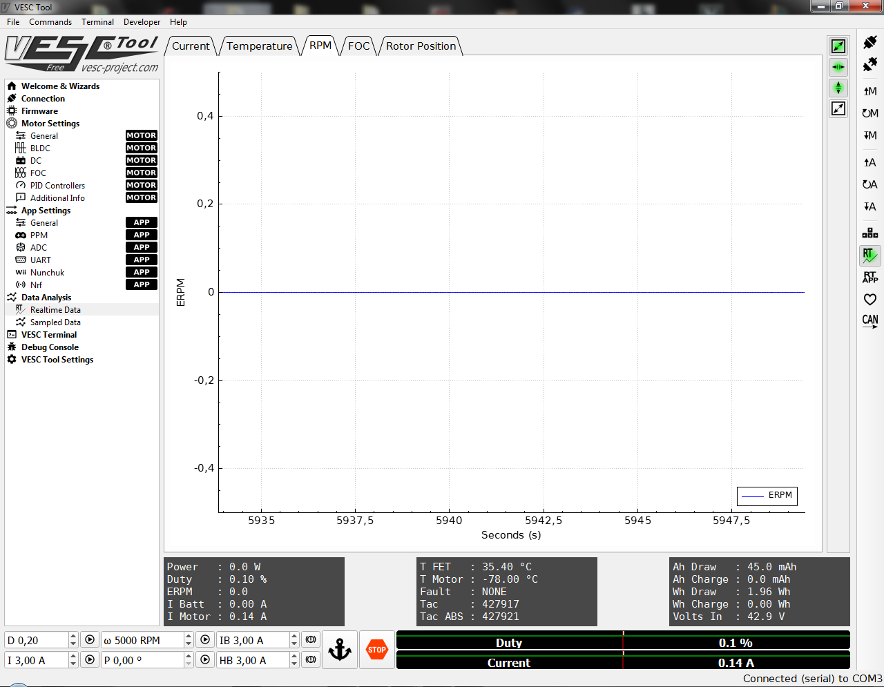

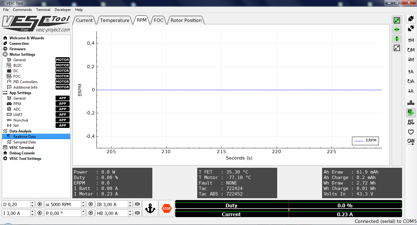

Here’s images from the vesc tool (taken at the same time on 2 pc connected to one VESC) whitout pushing the trigger. As you see at the very beginning value are already differents.
They are both at zero erpms the one is drawing slightly more mah and wh but that’s is really it. It could be that one motor has a slightly different kv it should be ok.
