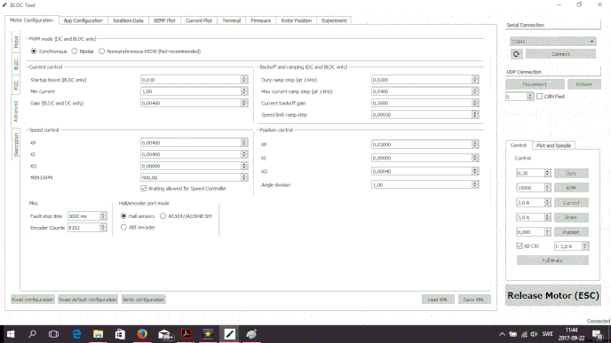

and I’ve been using the extended BLDC tool to set up FOC.

Hmmm in the video it sounds like at a certain rpm the motor hits some frequency that resonates with the board or some part of it. Try connecting to bldc tool and on the right set the rpm to where it makes the noise and check if there is something rattling or resonating. Maybe try a different motor if you have one…
