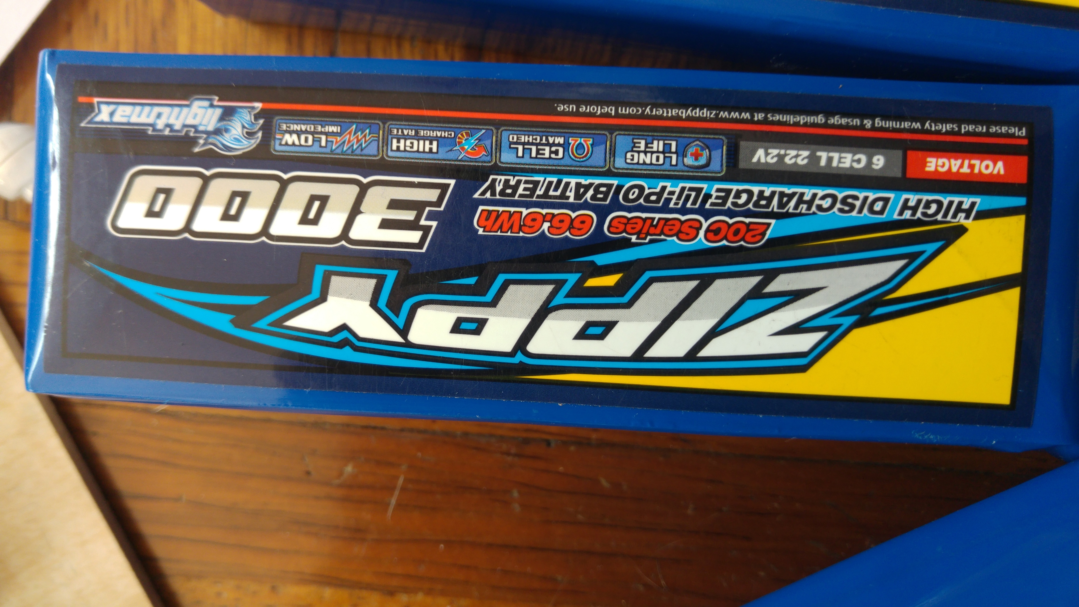

I have 4 batteries of which I will put 2s 2p
i have a quantum remote
But what cell count are the individual batteries?
This are mi batteris
nv.
6s1p (22.2v, 3000mAh) to make
Yes my complete battery are 12s 6000mah (24km aprox) 259.2w
