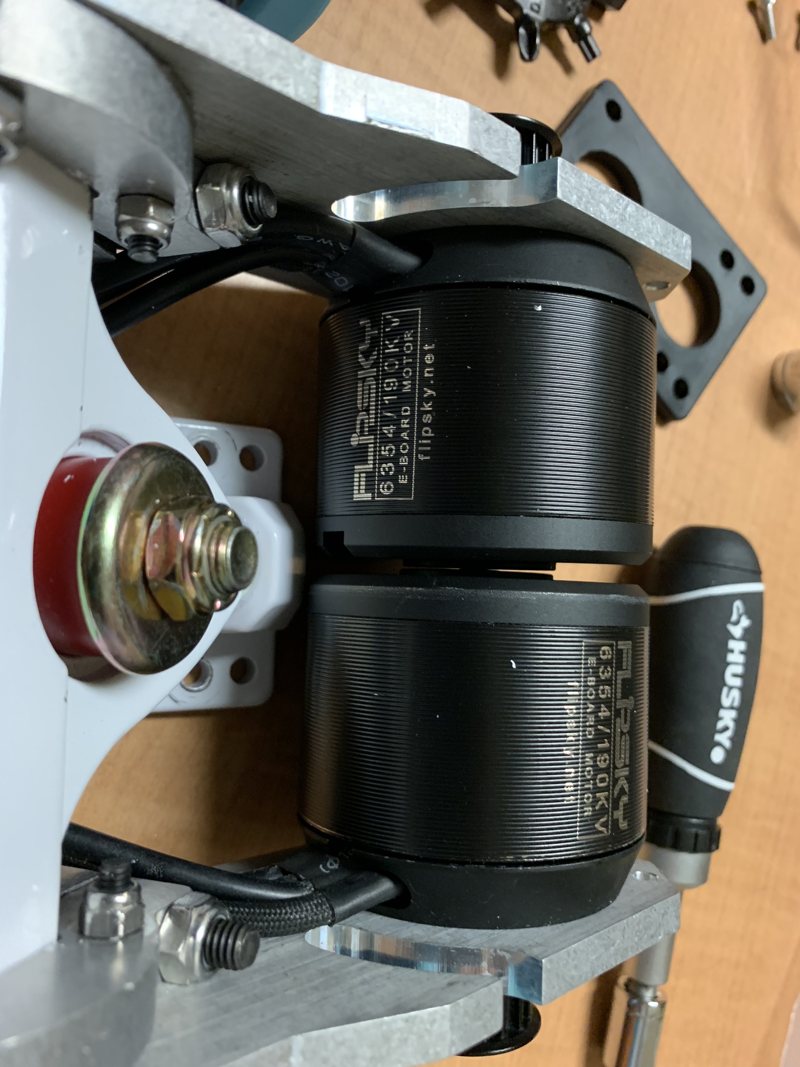

Hello esk8 community, I recently started working on my first esk8 build after many months of research on parts and compatibility. I’ve run into my first problem and I haven’t found a solution yet. I’ve been told that dual 6354/6355 motors will fit on caliber II trucks, but it does not seem like this is the case for my build. The motors either touch each other in the middle OR the motor mounts scrape the 36T pulley attached to the caguama wheel. There is no room! I appreciate anyone taking the time to read this. I’m open to any input anyone has to offer about my current problem or problems you can foresee in my parts. Thanks!

With the mount pictured, I was purposely rear mounting the motors. Are you saying I should mount the motors so that they point towards the middle of the deck rather than away?
Iv’e thought about this and I think it causes another problem. If I move the wheel further to the outside, doesn’t the outside bearing of the wheel no longer contact the smooth part of the truck. I think that the bearing would then be spinning on the part of the truck that has the threads for the nut. Is that a problem?
The problem is you are using 15mm pulleys. You should be using 12mm or 9mm. Meaning you’ll need to change the pulleys and belts. Simplest solution is mounting in dual diagonal configuration.
