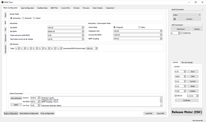

Here’s my VESC settings:
Is there something blatantly incorrect in these settings? Any help appreciated!
Im concerned about the erpm settings given my motor KV, but I dont quite know what to do with them.
set it to 60k max. Your motors are not the best to work with 10s… they are too high
thanks for the advice! Ill set the max erpm to 60k. Do you have advice on the min erpm?
Yeah, I realize now that the 270kv motors were too high, but it’s what Ive got for now. I can upgrade to 12s later. What are the downsides of running higher KV motors on 10s? Can I mitigate the risks with VESC settings?
ACK, I posted the wrong motors… these are the ones I have: http://www.diyeboard.com/180kv-n6354-outrunner-motor-2000w-for-diy-electric-skateboard-p-540.html (180KV). I had originally ordered the 270kv motors but returned them because of this reason.

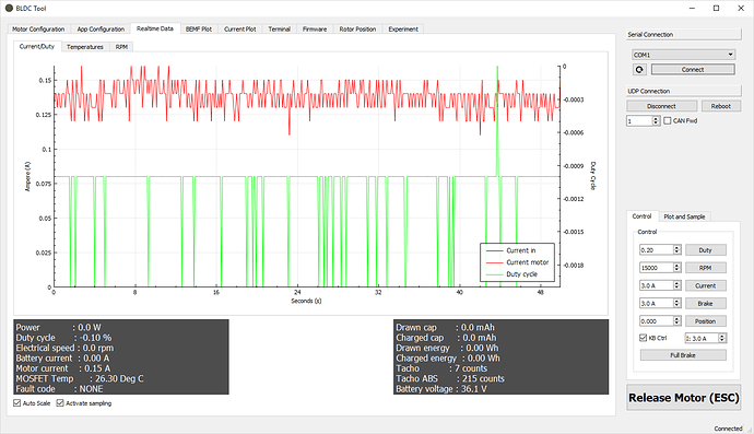

Im getting closer, but struggling with the VESC set up. I am able to spin both motors when the board is not under load (when Im not standing on it), but when I do stand on it the motors feel like they are “shuttering” for lack of a better term.
Also, my realtime data graph looks like this:
I feel like this is abnormal - anyone have an idea what settings are incorrect which are causing this behavior?

You mean you just stand on the board and expect it to go? You gotta give it a push in the right direction, otherwise you’ll expirence cogging
Oh damn, no way. I just assumed… sigh. I have limited space in my current workroom so Im not able to do that in here, which is why I didnt think of it. Ill have to take it outside and give a try, strapping down the components for now until I build an enclosure.
Any thoughts on the graph data?
Yeah, that worked alright… a little nudge and the board went flying out from under me and left me on my ass! It seems like its going 0 - 100 instantly
Yup, its an art to get goin slowly! From my understanding you need to make it a sensored motor to get the cogging to atleast be mitigated. I have sensors I need to put on this weekend to try that out. Basically wothout the sensors, it doesn’t know that the motor issn’t spinning so it doesn’t ramp up the power to get you initially moving.
Annnnd I think I somehow just fried a VESC… isnt responding to power like the other one or as it was a few minutes ago… shit.
