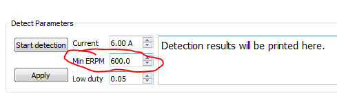

you may need to play with your detection parameters, what is your motor Kv and battery setup?
sk3 149kv, 10s. Default settings worked fine with the other controller, but not the focbox.
lower your min ERPM to 500
could also increase your low duty to 0.1
could also double check your battery voltage for funsies

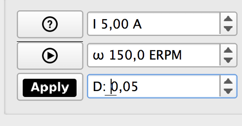

battery voltage is ok. these are the default values. ERPM is set to 150 by default. Increased D to 0,10. No difference. Motor still stuttering at the end.
motor detection worked with higher A and ERPM, but it still stutters at the end of the sequence. Normal?
yeah that is the D value, you can play with it to get to to run smoother. but if you get the detection working, IMO, not worth it
