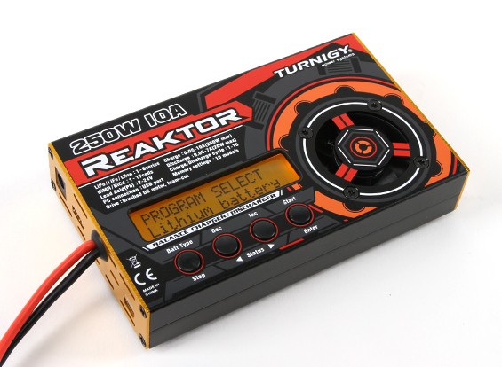

Battery charger:
50€

First of all:
  • Go for a 10S battery (buy 2x5S Lipo or buy or make a 10S li-ion pack)
  • Get a 10S bms and a 42V charger
