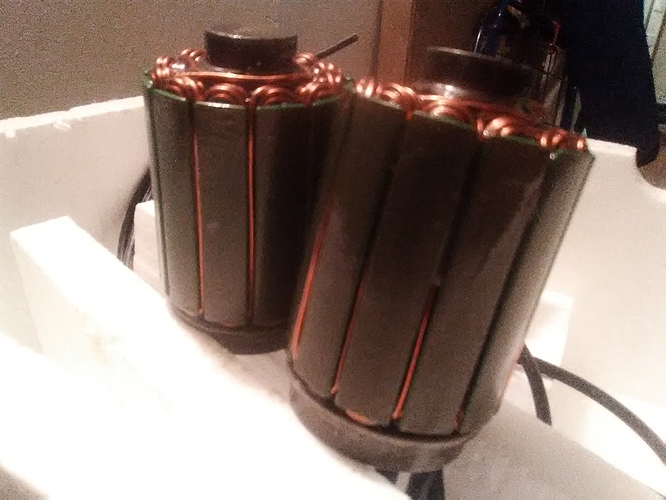

BTW which seller can you recommend to get 20AWG insulated high heat copper wire ? I wanna upgrade my windings. Opened my motors and was like “Damn it is 29AWG or what ???” The real question is : how can I be sure that I’m keeping the same kv ? Should I count number of turns and make it the same ?
Once I’m done I’ll do the redneck way : add more magnets like I’d add cubic inches inside a small block V8 !
EDIT : I got an APS 3300W motor to be delivered. I’ll check the wire diameter since I’ll hack through it.
I use Remington Industries 20 awg high heat wire. Great stuff, and works well.
To figure out how many turns you want, the best is if you can count it while unwinding.
if you have an inductance meter, or that feature on a good multimeter, you can see what the inductance is per phase and that’s a lot easier than trying to count the windings that are on there already especially because it’s likely a multistrand winding and maybe 4 thin wires doing all the same amount of turns. find what the inductance is and you can replicate it as you put the new on. be prepared to spend many hours removing and winding.
Thank you for the tips.
Another question : can I bind strongly around the stator or I risk damaging the iron? BTW I have to look how the 3 wires go all around (beats my common sense)
I’m thinking of crafting a tool with the 3d printer to make the turns less difficult (make walls between phases) and pack it tight.
A tool made on the printer I’d be interested to see. So far the best tool I have beyond bamboo skewers is the hole cover on either end that holds the wires from blocking the shaft hole ehen putting it together after winding. Done that too many times. U won’t damage the stator winding. U could damage the insulation on the wire but if the stator is well insulated its unlikely you’ll scratch the wire. The danger is a bare corner on the stator that scratches the insulation on the wire and then u short through the stator.
lve been doing tons of the dlrk winding and terminated wye. A classic u can find a guide for
The biggest reason I don’t like putting these MOTors together and am hoping to slow peoples roll till the new show is theres 1.5mm less room for the end turns to fit. Everything must be perfect and adding the leads is surgery
hadn’t anticipated getting as much copper on had to put the “transits”( wires going between teeth you can see in the photo, on the other side of the motor) to make it fit. but these just sit here and I’m not going to put them in the oven or waste magnets on these. we’re all going for the better big gamble with the new design. god forbid it has a problem I’ll send the 15 of these I have to people I owe. we will see. I’m drinking beer waiting till this coming week. I hear from @evoheyax that the tire’s core are a bit subacceptable and gunna get an aluminum done for sure. thanks and @ralphy for saying it and showing it I think you’re right and don’t want to mess with the pu core… a relief really. ill get those designed and ordered. aluminum is of course the best, and the huge contact area for the urethane to adhere, that much shows true. but I don’t even ride with this and that and wait for the new and it’s just @evoheyax and I translate to the custysYour welcome man. Keep at it and im happy to share what i have learned to make this sport safer and more reliable. Once you get everything worked out id like to get a pair myself.
