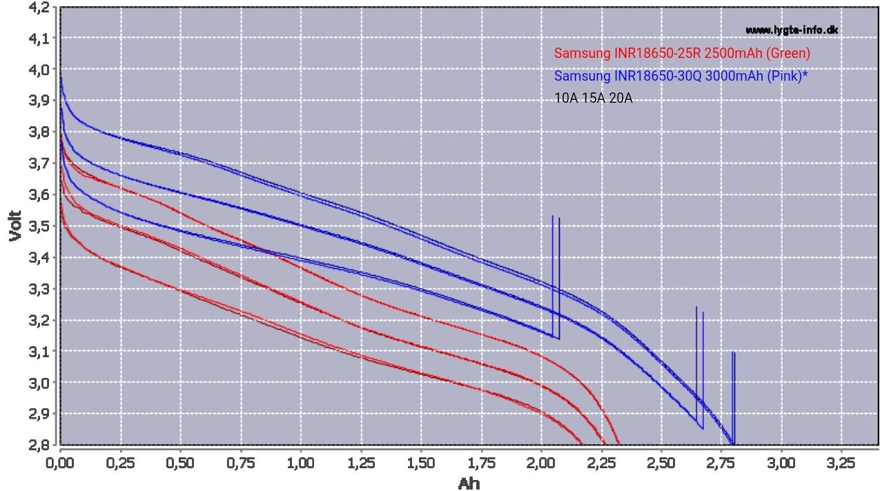

I ride 25r in 10S4P. They do sag quite a bit under full load. More sag than I’d like, but other than that no issues pushing 20A per cell from the pack.
Based on the chart below, it looks like 30Qs do much better in terms of voltage sag at 20A than 25r, but also that at 20A continuous the 25r can push 20A for a bit longer.
Other than that, our loads are usually not continuous. At 15A, the 30Qs fair much better both in terms of capacity and sag. This lines up with the general consensus of the community that 30Qs are better for our application.
