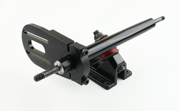

You mean like this!?
Yes like that
For more details of this mount, here is the link:
how do you turn dude?
Just to demonstrate dual 6374s can be mounted on TB218mm, the actual setup would have a longer arms to clear the deck for turning.
ahh yeh it indeed would thank you for explaining I imagined you were just steering with the front which wouldn’t be ideal, looks cool!
you only need one set of trucks to turn, learn to turn with just the front
These mounts are reversable and can be set at any angle you like
It’s a TB218 truck with two HobbyKing SK3 6374 motors… which really are 63*86mm external dims
Do you have a link for these? I’ve only found ones for Paris trucks
