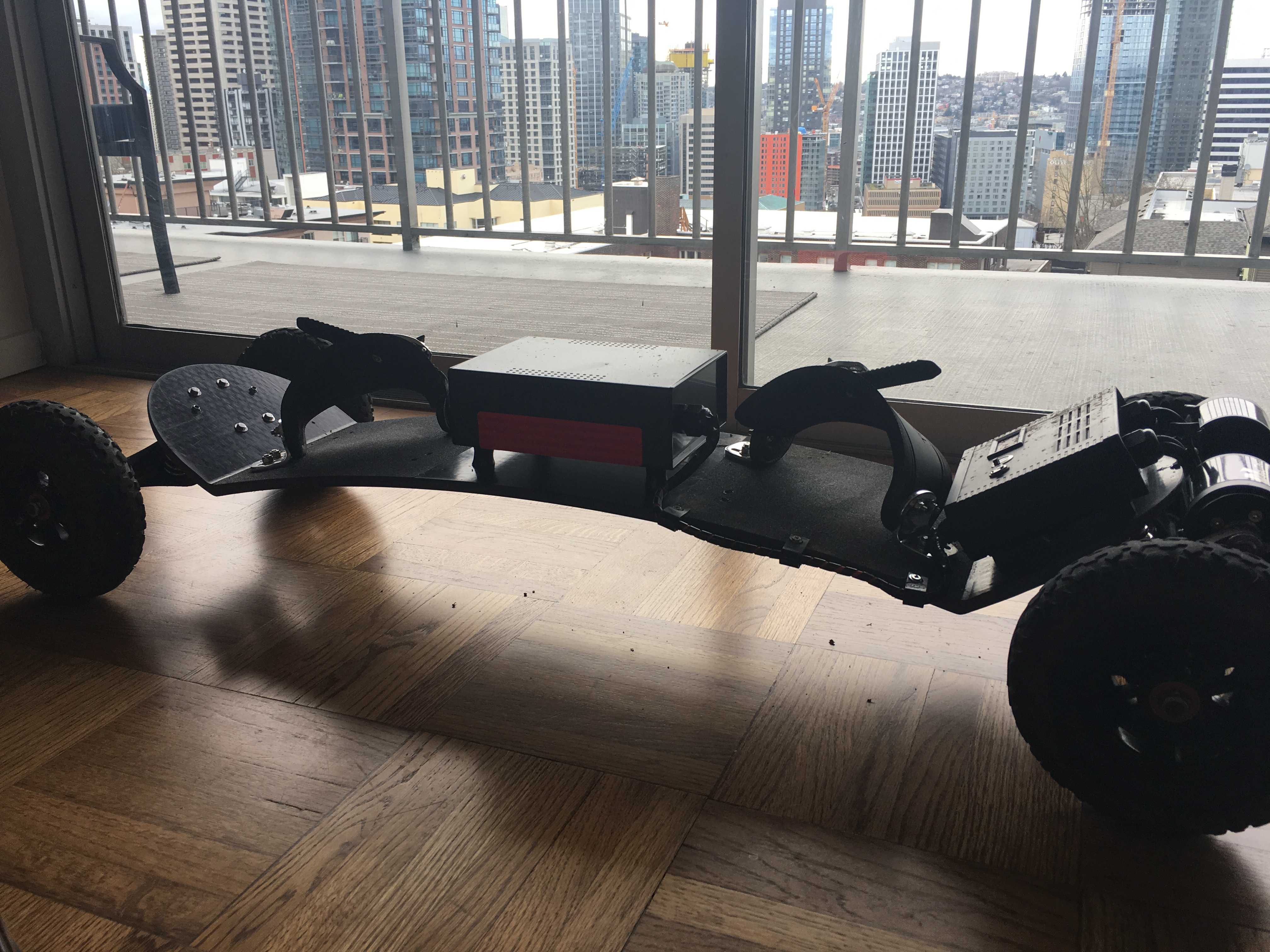

Killing me… Every time I get cleared for flight, something else goes wrong with my Tramp/SCRAM. First it was a charger that burnt out (replaced by SCRAM eventually…) Then is was wired slightly disconnected from motor which made it run like 2 miles per hour on one motor (easy fix). Then it was a remote that wouldn’t charge($100 to replace…). Then is was a motor mount that fractured at the weakest point of the plate that happened to also have cut outs on it (designed obsolescence?).
And now, it’s a real mystery. Charged for a full 4 or 5 hours. Changed tires while charging… Turned on to check level of charge, and it briefly read 41.6V then turned off by itself. Pushed on again and nothing, tried again nothing, tried again turns on, displays 41.6v then cycles off. Will only stay on if charger is still plugged into it. One last bit of the puzzle… the charger slowly flickers between green and red led… why would it do that? Anyway, nice folks at SCRAM suggested I cut one of the resisters on my BMS. Ouch! I don’t want to disable anything that was originally engineered to support my battery health.

Ok, back in Seattle. Disassembled, inspected, reassembled electrical connections. Buttoned everything up. Didn’t actually see anything wrong, but when I powered it up again, it would stay on. Thankful for small miracles. And Thanks to all who jumped in to help. I Like the community.
Two good things have come out of this experience. First, I bought and kinda learned how to use a multimeter. That will come in handy. Second, I now want to build my own from scratch.
