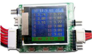

I would also recommend using a battery monitor like the BM12 pictured below:
tapatalk_1532312128751
That helps you see every S connection and make sure they are discharging evenly
