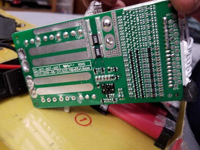

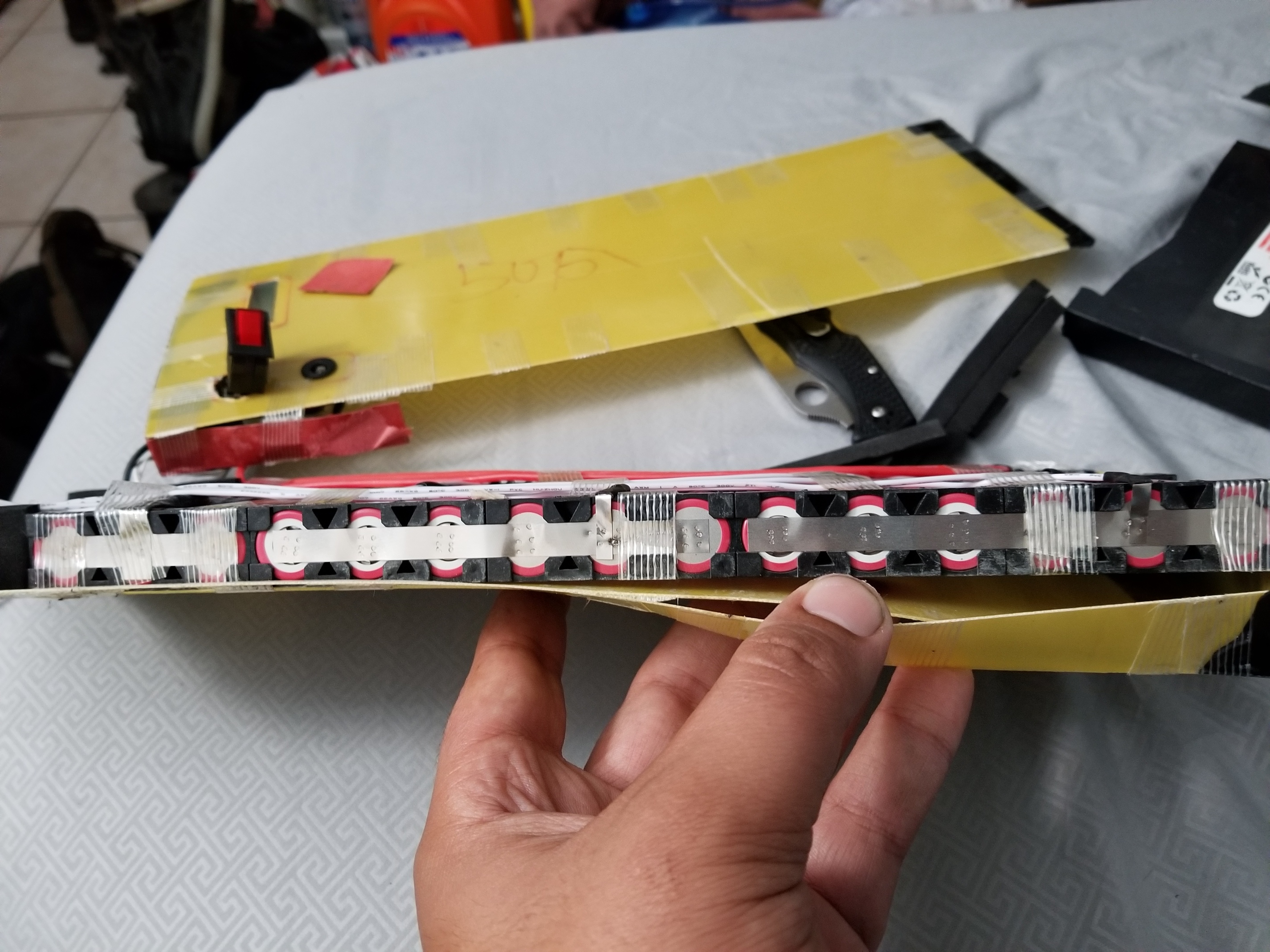

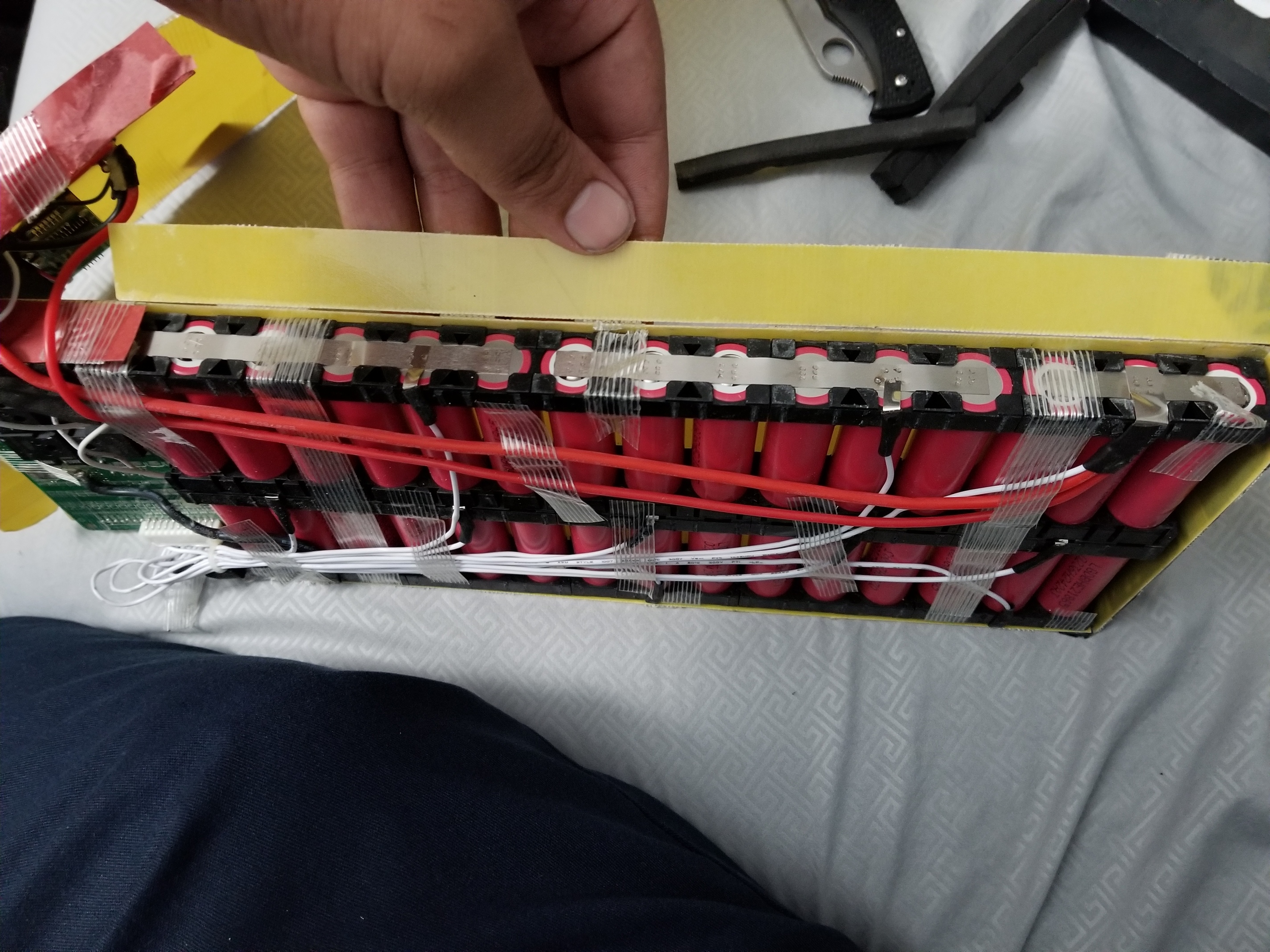

So I had time to dig into the battery today, I still havnt found my multimeter but I found all Nickel strips to be in tact all my balance wires also in tact, I’m inclined to believe it’s the BMS that failed. Another weird thing is does that I probably would never catch with out having another good space cell is that the Bad space cell turns on the display while charging no matter the switch position and the good space cell only turns on the display when it’s powered on whether it’s charging or not.
im looking for a BMS would any cheap 10s lithium BMS work? i was looking at this one http://www.ebay.com/itm/36V-37V-42V-10S-45A-Lithium-ion-Li-ion-Li-Po-LiPo-Polymer-Battery-BMS-PCB-System-/322445471781?hash=item4b133f7025:g:VJcAAOSwTuJYvS8E
ideally id like to not have to rewire a BMS it would be cool to get a BMS that i can just plug in my balance leads into, i dont mind soldering but if i dont have to soldier the battery pack i wont.

hmm after all this time i get the BMS in the mail and i realize the bms has 10 balance wires and the space cell has 11 balance wires, is this the wrong bms? or can this be wired differently?
also i dont think this BMS has any switches? i understand how a diy battery works but i asked for a replacement part not something i have to modify… i feel like i wasted my money.
space cell has a B- as one of the balance leads, your new BMS uses the B- terminal on the BMS for this.
