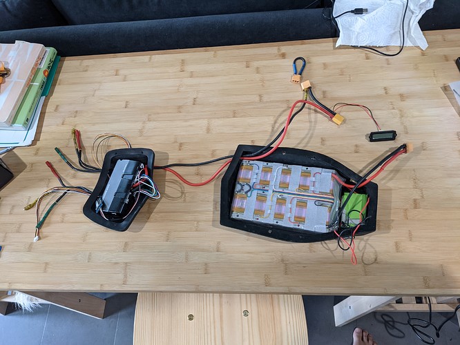

Hi, first time builder and can’t seem to get it to work. I programmed and tested everything last week and everything worked fine. When I went to fully assemble everything today my Stormcore won’t shut off. I hold down the power button and it turns off but comes back on a couple seconds later.
I also made a loopkey but when I plug it it, it sparks. Also, wondering if it’s normal for a battery meter to always be on.

I will answer this 2 ways for you. Yes it can always be on depending how you connect it.
In most cases it will stay off and you will have a anti-spark switch or loop key after your battery.
ESC (some Esc’s have a port to plug in a meter. IE Unity)
The Goal is you want to have a switch or loop key cut power to the battery meter etc.
So long as you put the black and red wires past the switch or loop key, which are the same.
You should have a proper working battery meter.
You can also put a switch on the battery meter to turn it off but thats not common.
Im sure its been done and still being done though. Really might depend on preference at that point but now we are steering from the topic.
