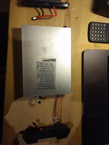

The charging port is in the bottom left of the picture and the battery connects to the electronics on the other end. Do you mean that the bms is build in along with the electronics? Because if thats true then the bms is on the opposite side from the charger. I thought it had to be between the battery and the charger?

The battery pack you have has build in BMS probably…you are connecting just the two wires to the charger when you are charging am I right?

If you plug it into a laptop style charger then it has BMS build inside the battery pack
