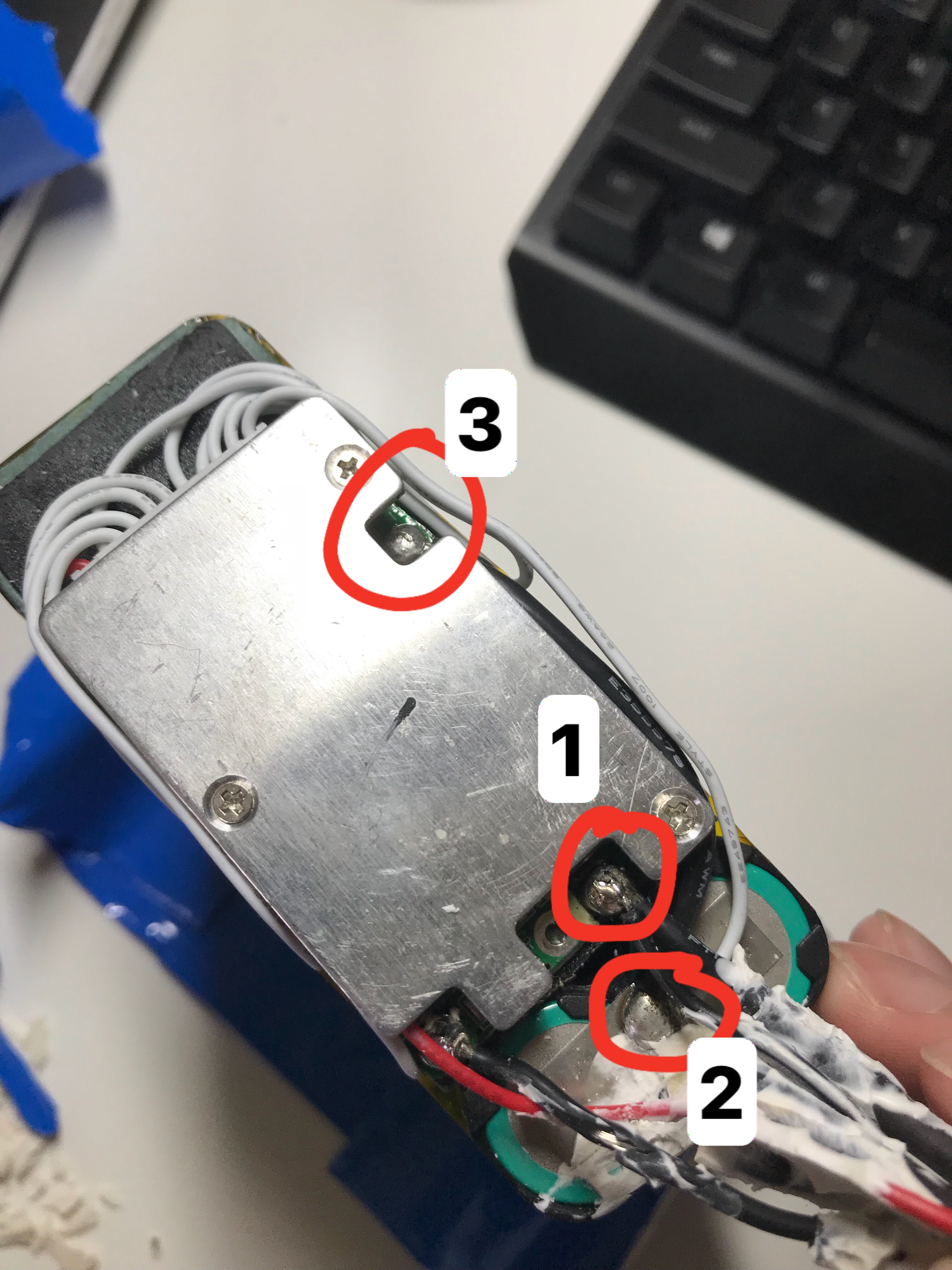

So now I’m having problem with the battery pack from Ownboard. The BMS went bad I think. It won’t power on unless I plug the charger in. I’ve already contacted them and they’re sending the replacement BMS to me.
Meanwhile I want to tinker with it a bit. Now (2) is connected to (3) on the BMS, and (1) is the negative wire to the xt60.
So now if I connect (1) and (2) directly I should bypass the discharge protection of the BMS right? I think I can use the pack again since the charge function seems to be alright.
To bypass the bms you need to connect the battery negative wire straight to the esc negative wire. do not short the wires across the bms, I feel like that won’ tend very well.
Thanks. I just did what I said above and it worked. I guess that’s how the BMS limit the discharge current
