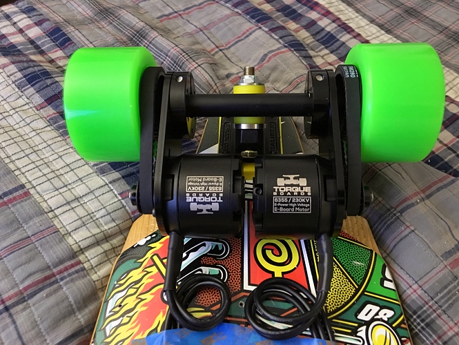

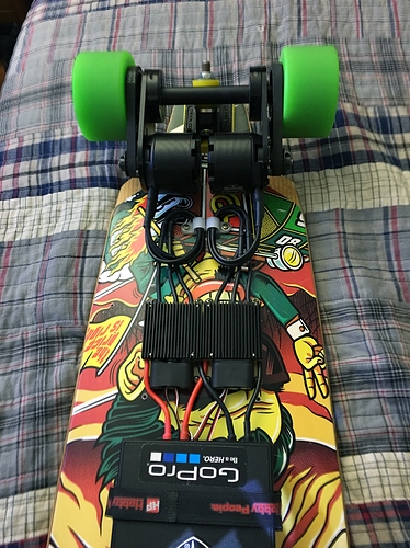

I’ve gotta jump in on this thread. Just finished installing this kit as a dual setup with TB’s 6355 motors. These mounts are easy to install and very solid. Truck mounts are 1/2" thick Motor mounts are 3/16" thick. They gave a huge range of mounting options. In front or behind the trucks. And motor hieght fully adjustable for a balance between ground and deck clearance. To shim the truck mount for final fit, I cut shims out of an old tape measure. Because the tape blade is pre-curved, it fit perfectly under the top of the mount. 3 shims under each mount and when tightened down they’re so tight that it feels like there welded on. I would highly recomend this kit!
When did you get yours?
Nice @torqueboards! Psychotiller approved!

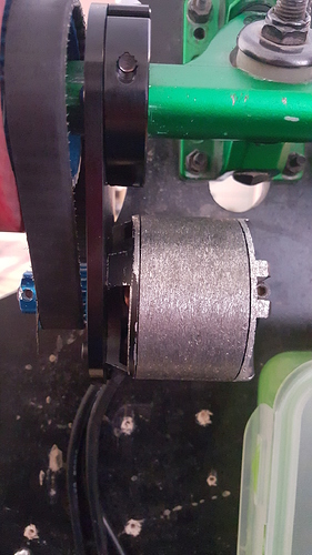

@Namasaki do the motor wires fit, when mounted towards the truck ?
Got mine about 4 days ago and went right to work on it. Had to relocate the battery box and Esc’s. Ran the motor wires in a loop do I didn’t have to shorten them and as the trucks swing back and forth, the wire connectors don’t come unplugged.
I considered every possible configuration, even considered mounting the motors behind the trucks. To make the wires fit under the trucks, you would have to remove some or all of the shrink wrap so that you could bend the wires where they exit the motors. And then worry about the spinning motor shell touching them. Unless you planned to run them through the board.
I run them through the front. That way you can have the mount closer to the deck (further away from the ground) and no risers if you wanted. As long as their is slack, you can turn the trucks and notice how much the motor wires actually move.
I was thinking of mounting the bolt holes so you can position or angle towards the bottom back right but then you worry about the motor wires hitting or getting eaten by the motors.
@Jeff - Great to hear. Mine on HexTKP Work great. I just added a few heatshrink around the actual adapter to prevent rotation.
