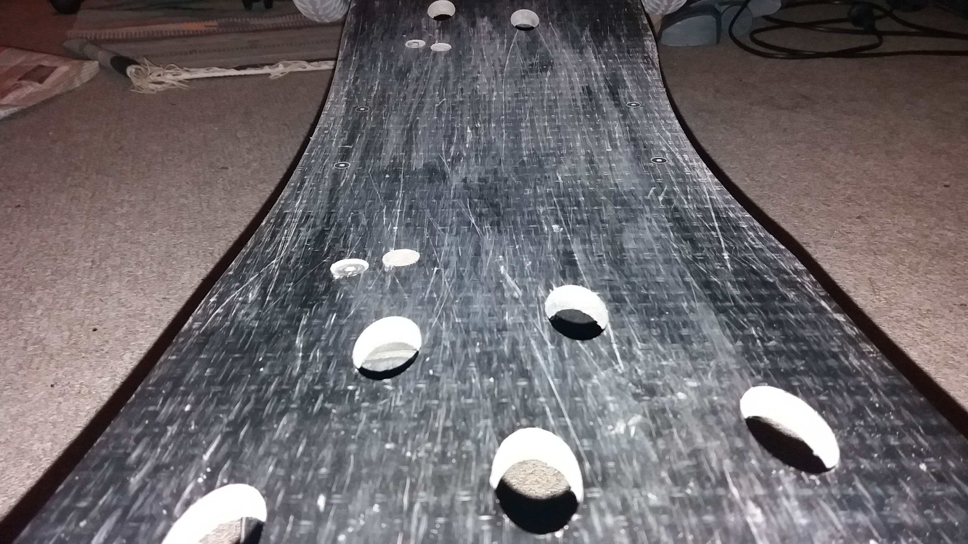

haha, I didn’t like the holes…Was just gonna do grip. But thats a good point.

I reduced the area of griptape to the absolute minimum, it’s very easy to clean now with less grip.

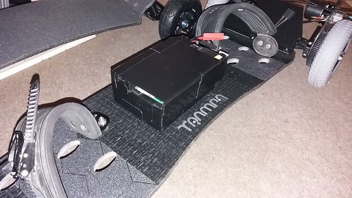

Personally I use a Pelicase 1150 but don’t like the look at all. On the other hand it’s bullet proof with 4mm (1/8inch) ABS shell, a sumo wrestler could jump on it without worries. But I plan to build smaller swappable custom cases in the future.
Just to demonstrate it, first pic is my 12s 8Ah Graphene Lipo with bestech BMS naked, second pic hurts my eyes but this is how it looks with the case
