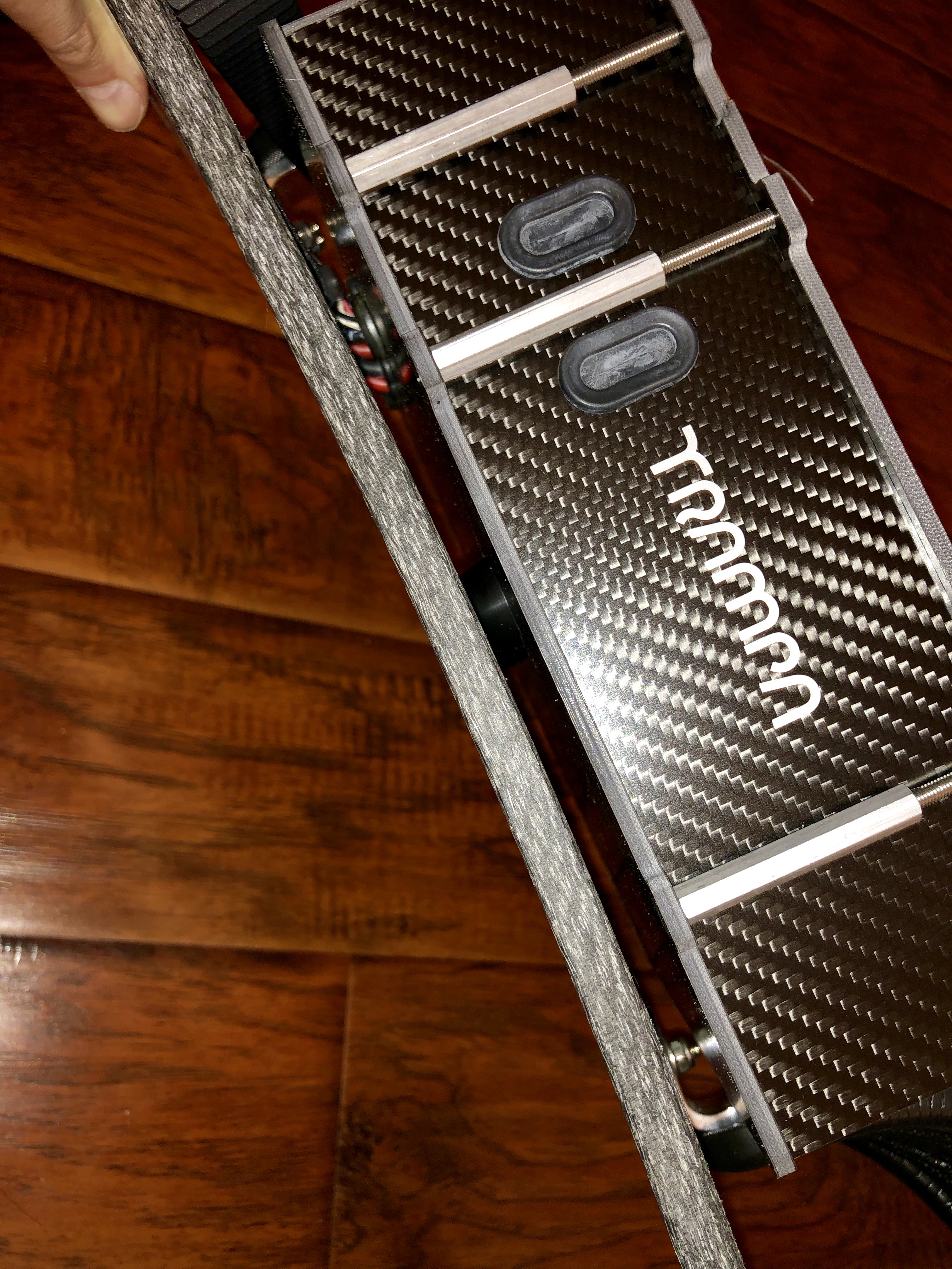

I’ve purchased a trampa monster box enclosure and wiring kit.
I’ve got a couple of questions if you can point me in the right direction.
Where do the rubber grommets go in the photo below? There are 3 of them.
Also in one of the pictures below there is motor sensor cable extender made out of circuit board components, where would this go??

This link might be the answer to one of your questions:
The sensor extension goes into the channel on your deck (if you got one):
Hey bud great choice. I’m seriously thinking about putting Monster Boxes on all my MTBs.
The rubber grommets are placed between the Monster Box and the Trampa deck
The PCB is for the hall sensor cabling; very clever bit of engineering. It sits in the HolyPro35 eMTB deck which has a CNC milled cutout for cabling.
Hope this helps!
