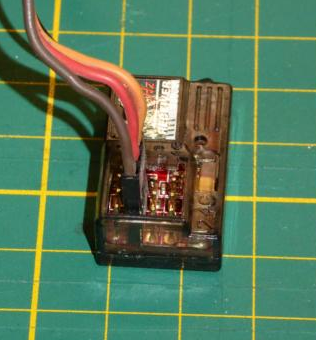

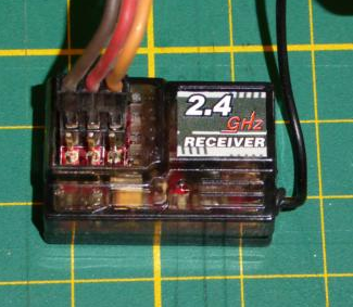

Check if Remote correctly bindet to reciever.
Led on the reciever on?
Connectet to port 2 ?
