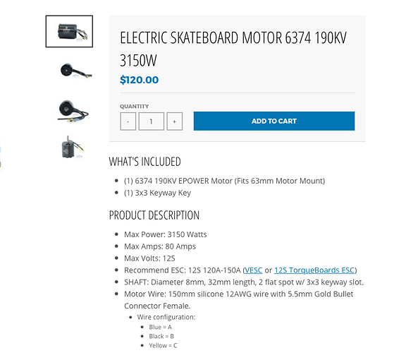

100A seems to be pretty high for a 6374 with 3150W, but if the difference is substantial, I’m willing to risk my motors, on the other side, if the increase on torque is barely noticeable as the motor limit keeps on being exceeded, then I’ll stay within the limits of the motor rating. I guess this is something I’ll have to test myself. Can’t wait for the VESC tool update to be able to communicate through the hm-10 Bluetooth module to change VESC settings on the fly.

What cells do you have on your build? Can your battery produce more than 80A constant, 40A for each VESC? Are you feeling a noticeable performance difference between runing battery max 40A vs 50A?
