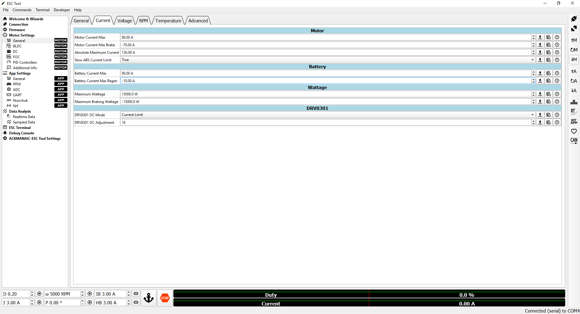

it would be best if you can post screenshots of your settings
Putting it to 10a seems to have solved it. I’m not entirely sure what the difference between now and then was, but I will go for a quick ride and see if it works under load. If it doesn’t work, I will post the screenshots.
you set battery regen to 10a? or -10a?
-10a sorry. Yeah it works now, brakes about as good as they can be with a single motor setup. Very strange indeed.

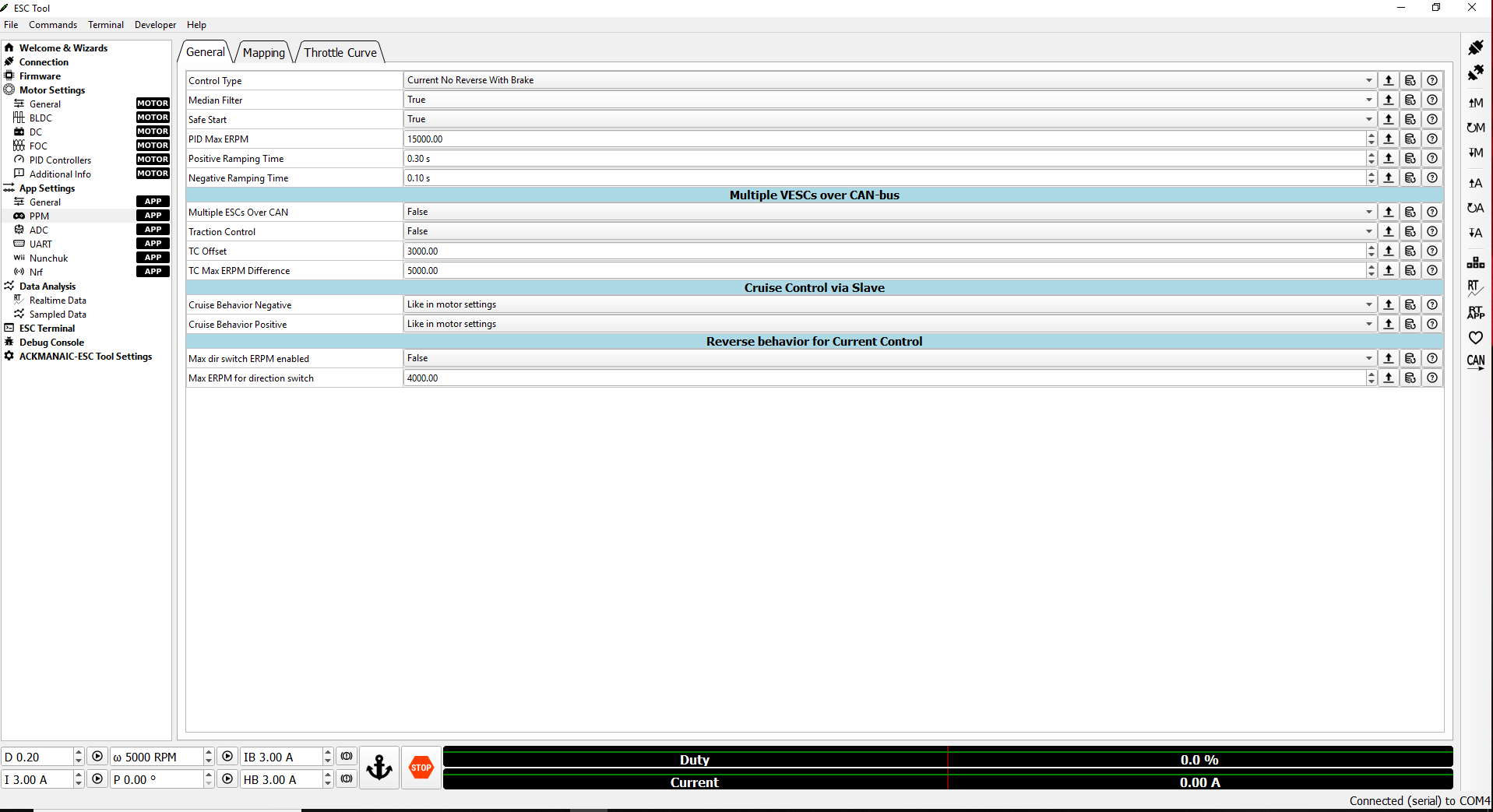

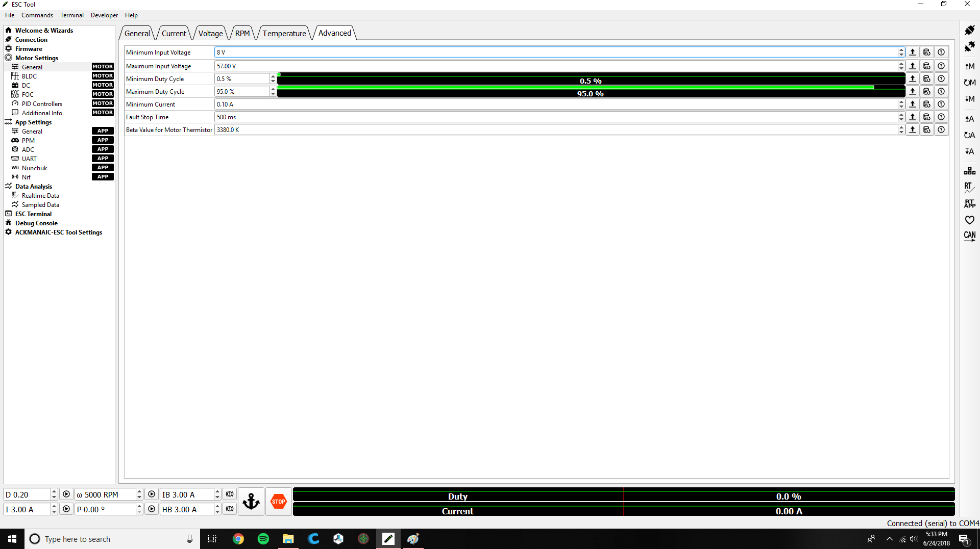

Nevermind, it’s doing it again. These are my settings.
Motor Current
Motor Advanced
Motor General
PPM
