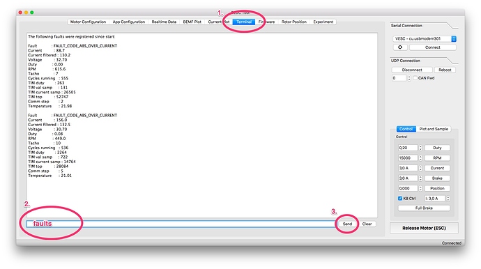

Next time it happens, plug your VESC into your PC (don’t restart your VESC), start the BLDC tool, click the “Terminal” tab. Then type in faults
and click “Send”.
If it’s a VESC fault, you’ll see it shown here.
