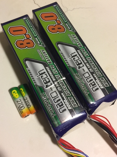

My setup is somewhat unusual. - Dual 5060 270kv motors. Build quality not the best but they work. - 12s Lipo, 8ah. 350wh. From two 6s packs. Turnigy nano tech. Hobbyking does not even sell one this large any more, I got these from a friends para-motor project. - 4:1 gearing. 3D printed gears I designed myself. This ratio is for reducing motor load and giving me a theoretical top speed of 40kph. And yes I have ERPM limits too, that seems to work perfectly. - 97mm wheels. - GT2B controller in mini buffalo case. *before the safety police come out, I have used lipo for years with RC models, I have a separate monitor for the voltage and have plently experience building systems that don’t burn down.
