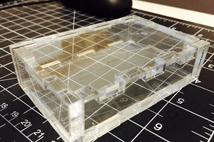

So I just finished turning my 6S Lipo board into a 6S2P Lipo board and I was stoked to give it a shot! So I plugged that sucker into the computer, ran a motor detect and hopped on it for a quick test ride. After riding around I decided I wanted more glue on my enclosure… (my enclosure looks a lil something like this…)

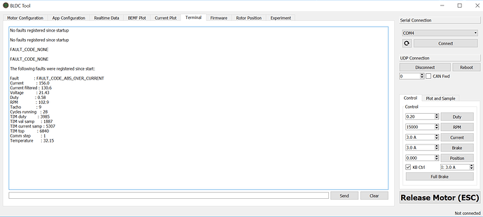

WTF It rocked a little bit backward, then a little bit forward about 5 times. Then it went FULL THROTTLE without me touching anything I mean nothing. The wireless remote was off and both hands were off the keyboard of my computer and this motor is going fast as hell. So I unplug the power and the motor stops. I plug it back in and run a motor detection, no issues. I press the arrows, slight twitch. I then replicated the failure by mashing the arrow for a few seconds and I hear the pop and red light flash. Here is my error code and settings:
I would really love some input here as I am completely lost as to WTF is wrong with my setup: Why does motor detection work fine? Why does the motor work for a few seconds then full brake? Why am I getting an over current fault? Please send halp.

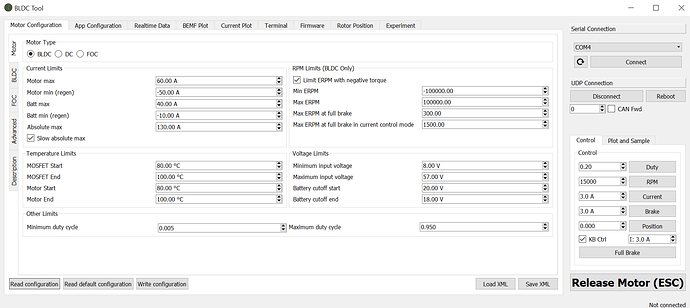

Hey, what firmware are you using? Can you take a screenshot of your advanced tab in the motor config? Also sometimes if you do your motor detection and have set PPM instead of No app it can mess with the results but I dont think that is your problem. Also do your motor detection without motor connected to the wheel. What happens if you hold an arrow key and “help the motor spin” with your hand? Does it spin up or not at all? Check your solder joints on motor connectors and on the VESC itself where the 3 phase wires connect to it.
Hmm, try lowering your motor max and see if it helps.

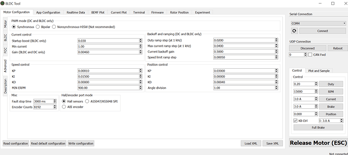

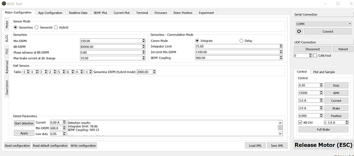

here are my advanced settings
Is it what you have set in the VESC? because it is showing that it is not connected… just to make sure :smiley:

The error you got means your throwing a fault due to too high of a voltage, likely because your input voltage is above your vesc’s max voltage. This would then lead the motor detection to work, but it would try to spin, and fail because the second it tries, it throws a warning and boom!
Could you post the main vesc settings again and post the voltage of your pack?
It’s a 6S pack max voltage at default 57 volts
Oh and it’s the VESC-X (I got it right before the rename)
So weird, that’s what it means, but if it’s at 57, then idk…
Sure it’s not current? the first thing it says is that somehow it hit 150ish amps
