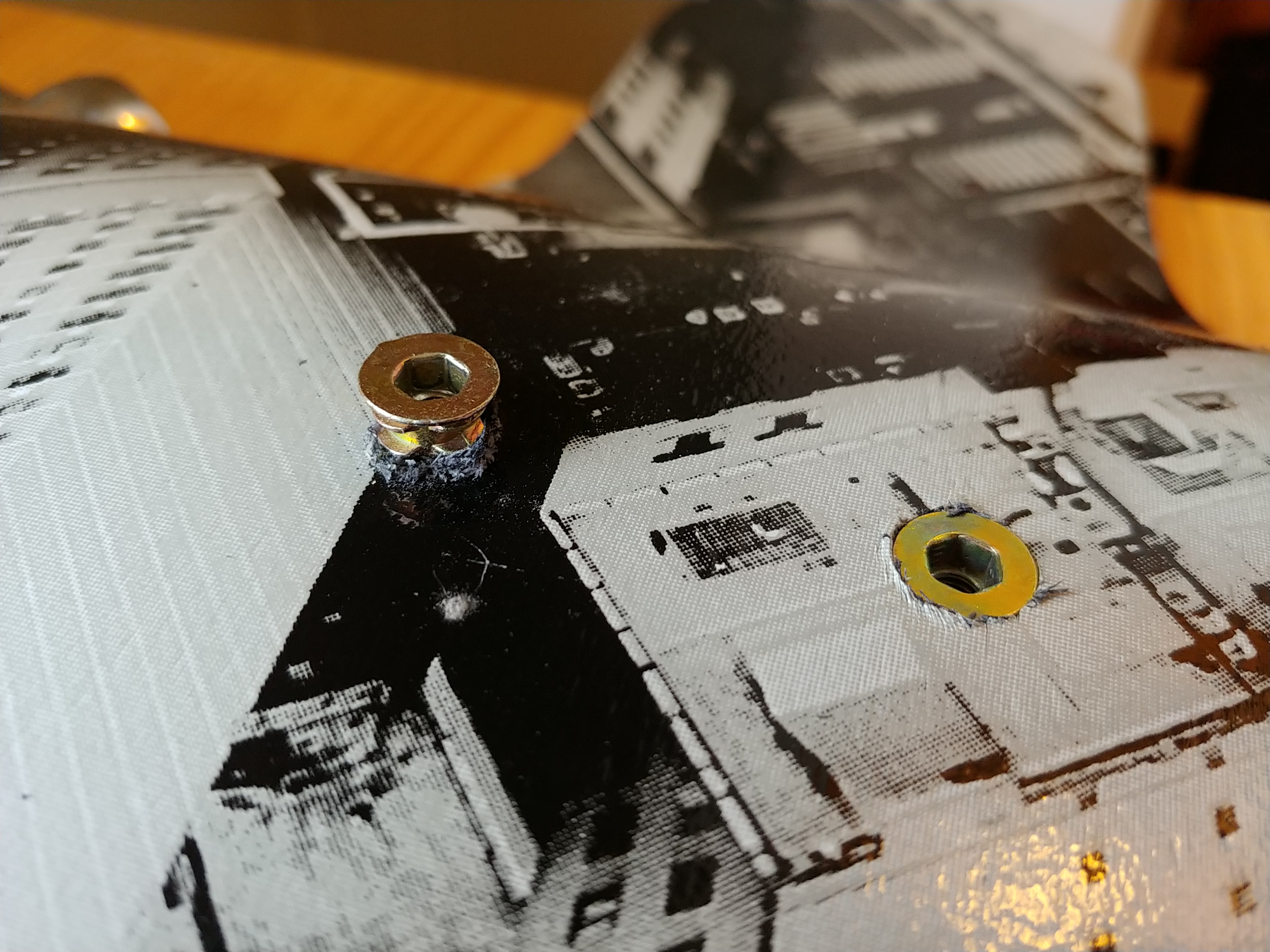

I tried it with 5/16 hole. Lmk if this looks ok IMG_20190409_184724
how did it feel going in? easy? snug? hard?
It was hard to get in. Had to use an electric driver. It feels decently snug. As in I can’t pull it out when the hex bolt is in. But I’m pretty sure if I screw it our in reverse with the driver it’ll pop out. That ok?
sure yeah…and as long as the wood doesnt split before it finally seats then good! i use a lil glue around the threads so it stays even better…as I plan on using blue loctitie on my screws so they dont back out from vibration… last thing u want is a blue loctite screw un screwing the insert at the same time… thats a PITA
