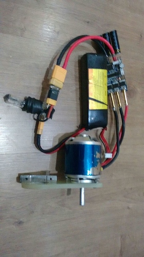

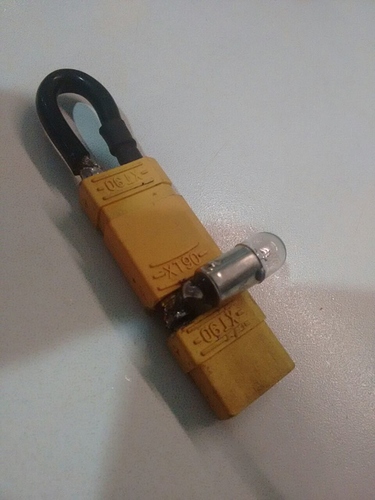

Motor detection works well hurray. Using my handy 24v headlight lamp current limiter with integrated switch, I have saved MANY electronics with this little device, I always use it to power up things the first time, case something goes wrong ( I have the bad habit to solder stuff with reverse polarity LOL ).

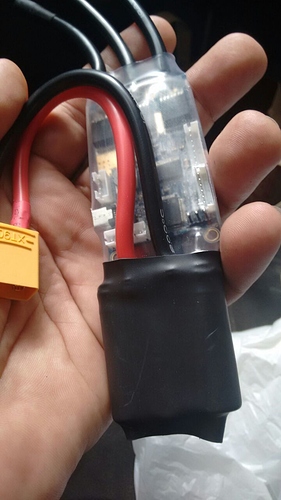

noticed also it doesnt play a tune during startup like all other ESCs was expecting something cool like star wars

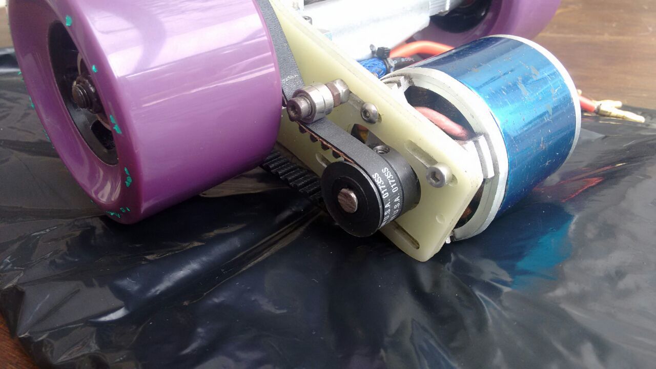

Just noticed my axles are bent… hope it does not give me problems with the drive pulley. OMG now I feel that I need to buy trucks. I gathered Caliber II 50 is the way to go, right?
cant go wrong with them.
The calculations gave me 5 teeth in mesh. So - an Idler pulley was installed (with no modifications to MM) . I couldn’t find the minimum radius for this pulley.

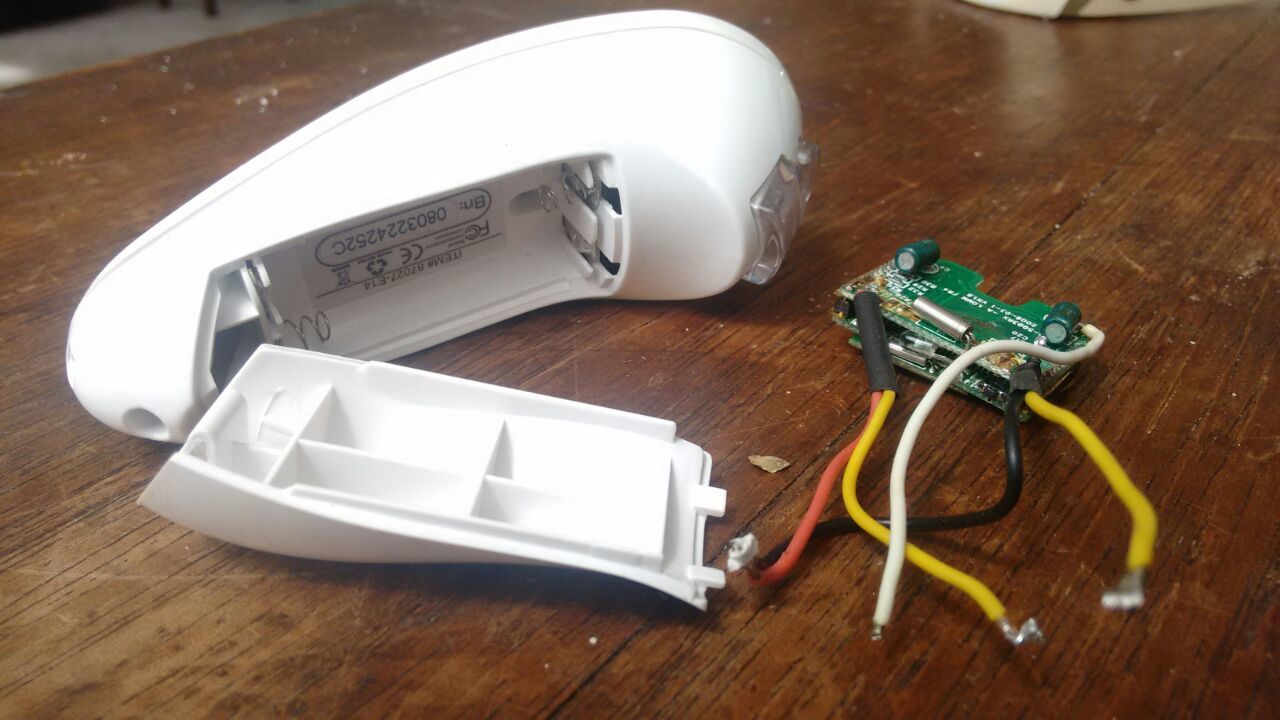

Sine I dont have a car RC controller, wired ADC to some handheld nunckuck.

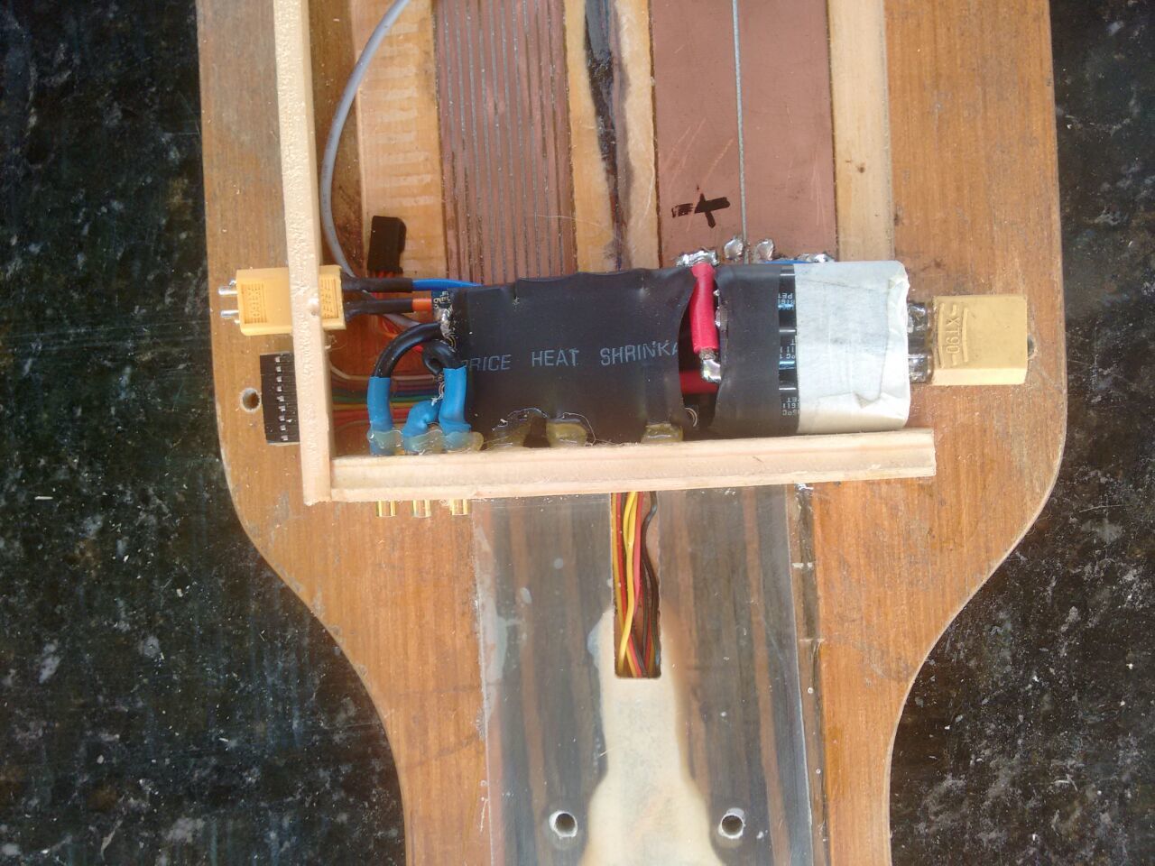

Using a Caslte Creations Phoenix 80 HV esc. Man I miss the VESC… it’s really night and day difference. can’t live w/o it.
Check out my anti spark solution while the xt90S doesn’t arrive.
Also, while remote doesn;t arrive, running wired nunchuck with custom arduino sketch I wrote to get cruise control. Works pretty well. Brakes when the cord is pulled or let go off the button.

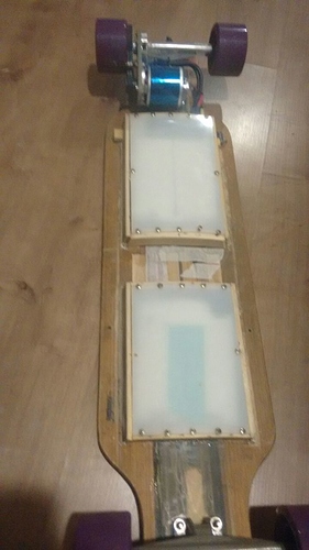

Got some miles on the board today. It’s riding very nicely and tomorrow I will do a 3K commute to meet a friend at a gas station to drive to our drone testing facility.
Very happy with the build. I’m spoiled, I really NEED my vesc back. The DRV’s should be arriving next week sometime. Other than that, she rides nicely with plenty of torque and pretty good hill climbing ability… I wouldn’t imagine needing a twin motor for now… but that might change with time.
