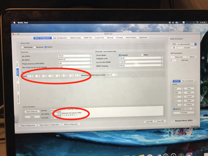

here are some screenshots. tell me if you need more
I’m not really sure, but if you look at the second Image, it doesn’t look like the sesors table as been properly apply
Ah the motor detection is from the second vesc. I reran detection for both vescs.
OK, but just make sure that the Parameter you’ve got from running a motor detection Sensors, integrated limits and coupling correspond to each motor in each vesc
