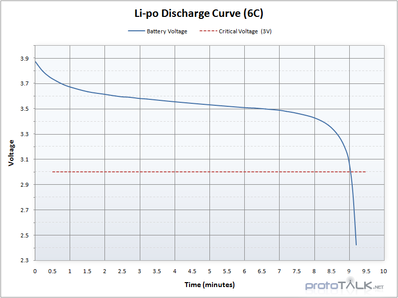

But to be honest, it simply won’t matter. The voltage drop on your battery will be significant once it’s nearly depleted. Look at this graph, at the start your voltage will drop quite significantly, then it’ll remain quite constant for some time and it’ll appear as if you’re barely losing charge. (For those with a % meter on their longboards, you’ll be finding yourself in the 80%-40% range, but suddenly, after dropping below 40% it seems like your batteries break and they suddenly get to 10% really quick! But it’s normal and putting capacitors in their won’t benefit this, it won’t matter.
But yeah, it’ll prevent that a sudden acceleration makes the battery drop a few % for a few seconds. But I do not see this as an issue as long as your cutoff voltage is set conservative and this issue decreases if the C rating of your battery is higher.
