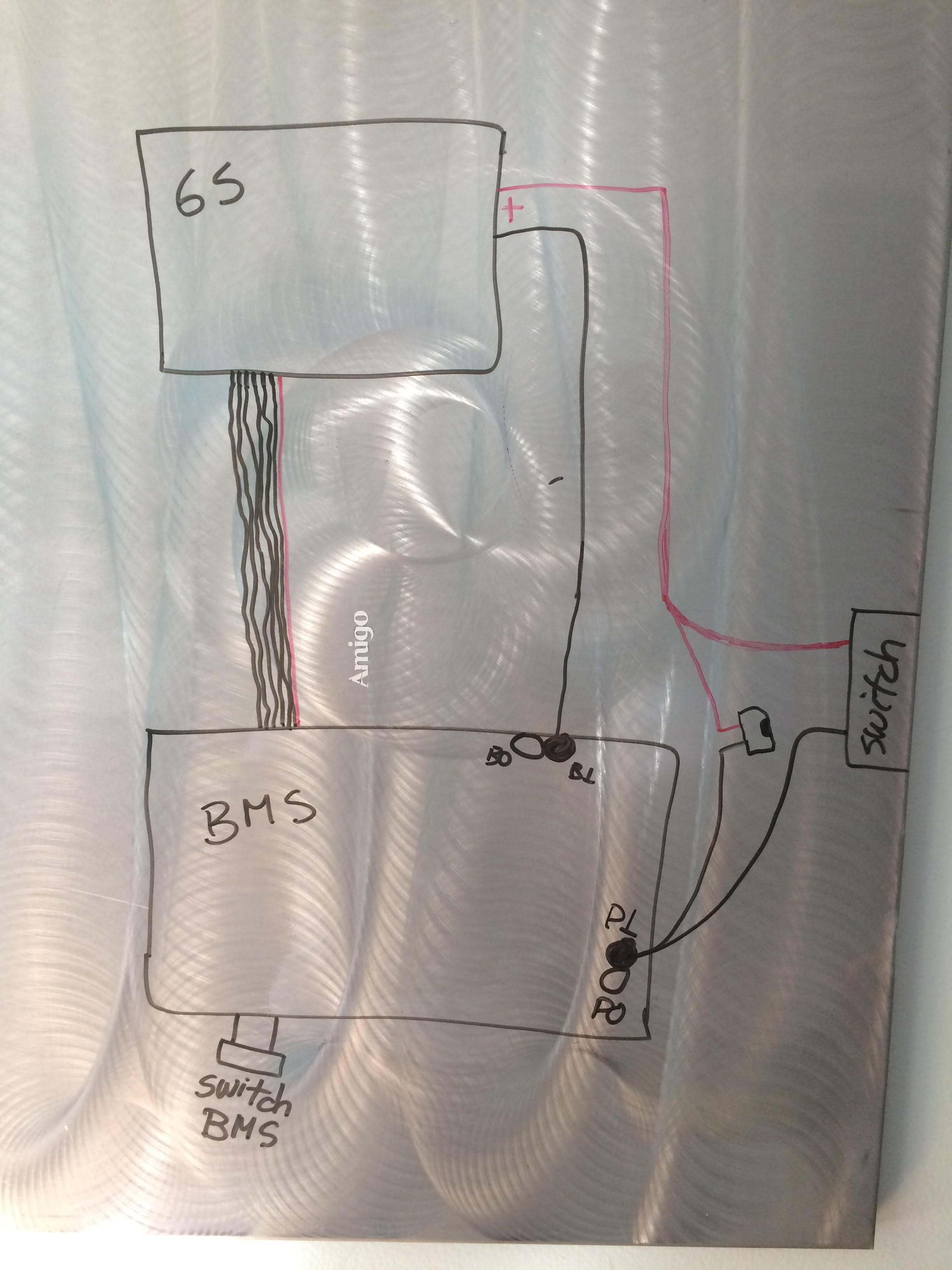

Hi guys, first I would like to say that Alien annouce a different BMS from the one that they sell and I wired it like the one in their site. Let’s continue, the Bms in the question is a PCM-L16S50-985, that works for 6-16S and I wired it like the Bestech one, unless for the balance cable that I adapted the one that came with the board for 6s (Picture 1). Fine, I connected the balancing cables and then plugged my battery and a big spark happened and started smelling like the BMS was burned, It burned my XT-60 and now I’m lost, I want my money back!

This one is my schematic

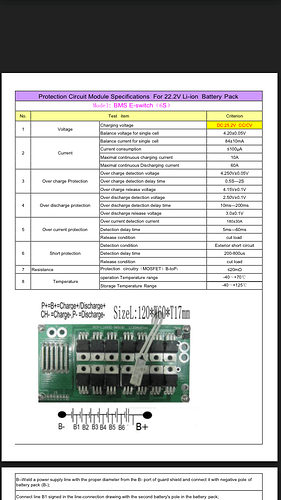

From the picture you posted above it wants you to put the first balance wire on B- them all of the normal balance pins, and then B+. Totals 8pins which is what you have

Normally you dont connect B+ to a balance pin, but it looks like your bms wants you to.

That is freaking strage, because Normally the BMS have not a B+, just a B-, and mine have just B-, so I tought that it was normal like the one they put in their site
