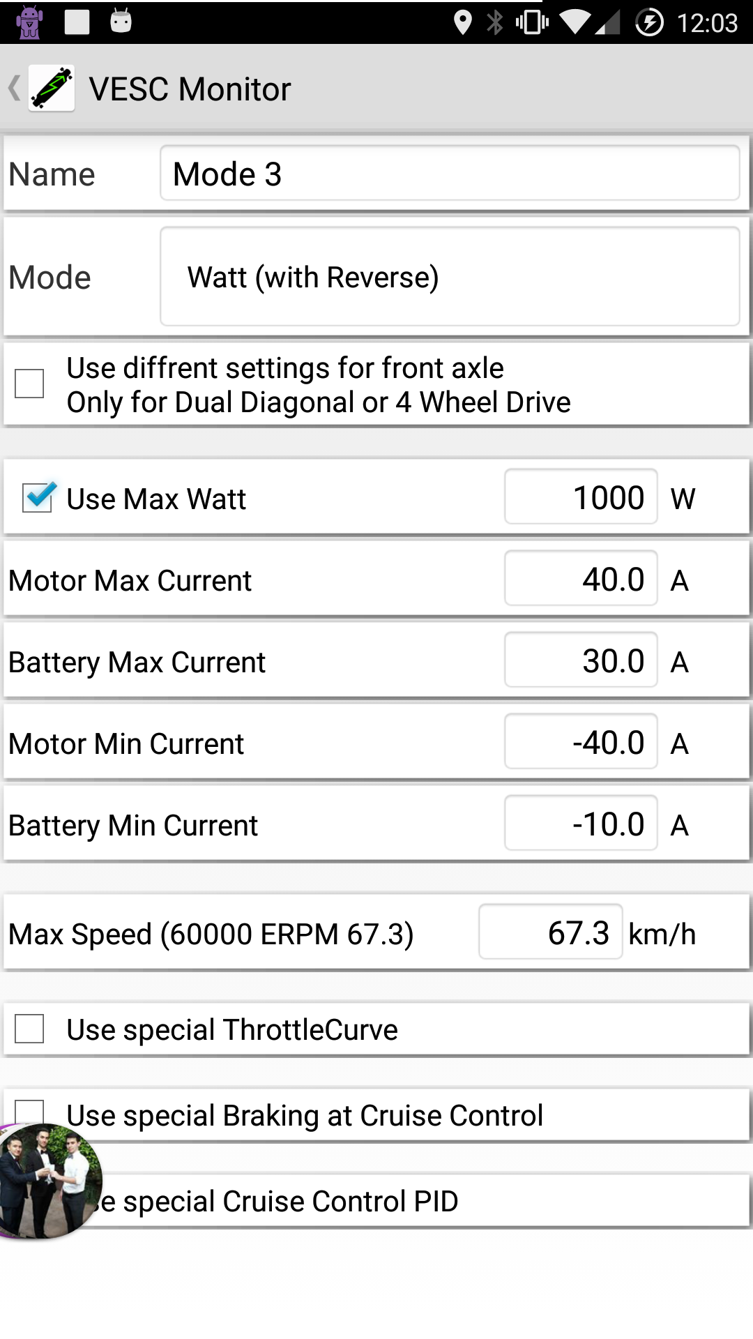

You can directly limit the speed through the erpm which cam be translated to motors rpm Which translates to wheel speed. Also ackmaniac firmware, that I know at least, let’s you set a limit directly for speed
So here if i reduce that max speed to 25 it wont go over ?
Not sure why but i did not changed that so far i will have to test it out
Yes, but tale care that you set up the correct pulley sizes, wheelsize and magnet count.
I have them set (not 100% sure about the magnets count i guess 14. I will ask to see for sure). But what will happened if this settings are off ?
This might be exactly what i need to limit the board for some beginner friends … few days ago one of them tried the board and he didnt really liked to go slow and he went to 30 35 km/h then felt … so from now on i will limit to ~25 for beginners just in case …

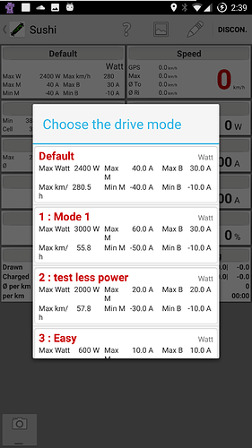

hey i just tested today and is not working for me i still got to 44km/h … any idea what am i doing wrong?
Which firmware do you use?
Your firmware i installee it like 2 months ago and ran watt mode
Was that max speed you hit maybe going down hill?
straight line when i left home i have a good straight road so i tested there and now agian … no sign of it stoping at 20km/h as i set it…
I can see that in the activated mode the speed wasn’t updated. Did you first activate the mode and the adjust the max speed? Because each time you make changes to a mode you have to activate it another time so that the changes take place.
i made the new mode then activated it … but even now when im activating it is set to 280 the Max km/h stay always at 280 no matter of what mode i select
Which remote do you use?
Seems that i have a error in the old firmware with the adjusted speeds. Need to have a look at it, in the meanwhile you can also use the new Firmware which is based on VESC-Tool firmware.
