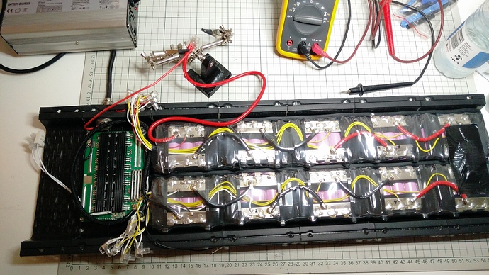

I just did a test charge for the very first time, and all seems to be working fine. I could monitor all the cells voltage with my multimeter and temporary connectors. And they all seems to charge pretty equally Without any load on P- and plus from the battery, with the E-switch off. I measure close to bat voltage between plus on the battery and P-. I have not received my focboxes yet. Do you think it’s gonna drain my battery over time ?

It’s still reading full pack voltage because there is no load to pull it down. As long as the bms is off your battery should not drain down.
Actually i dont think you are right. After 45min, the voltage has dropped 0.02v. I had an old car bulb laying arround, and now the voltage dropped to 0v. And the voltage seems stable for now.
