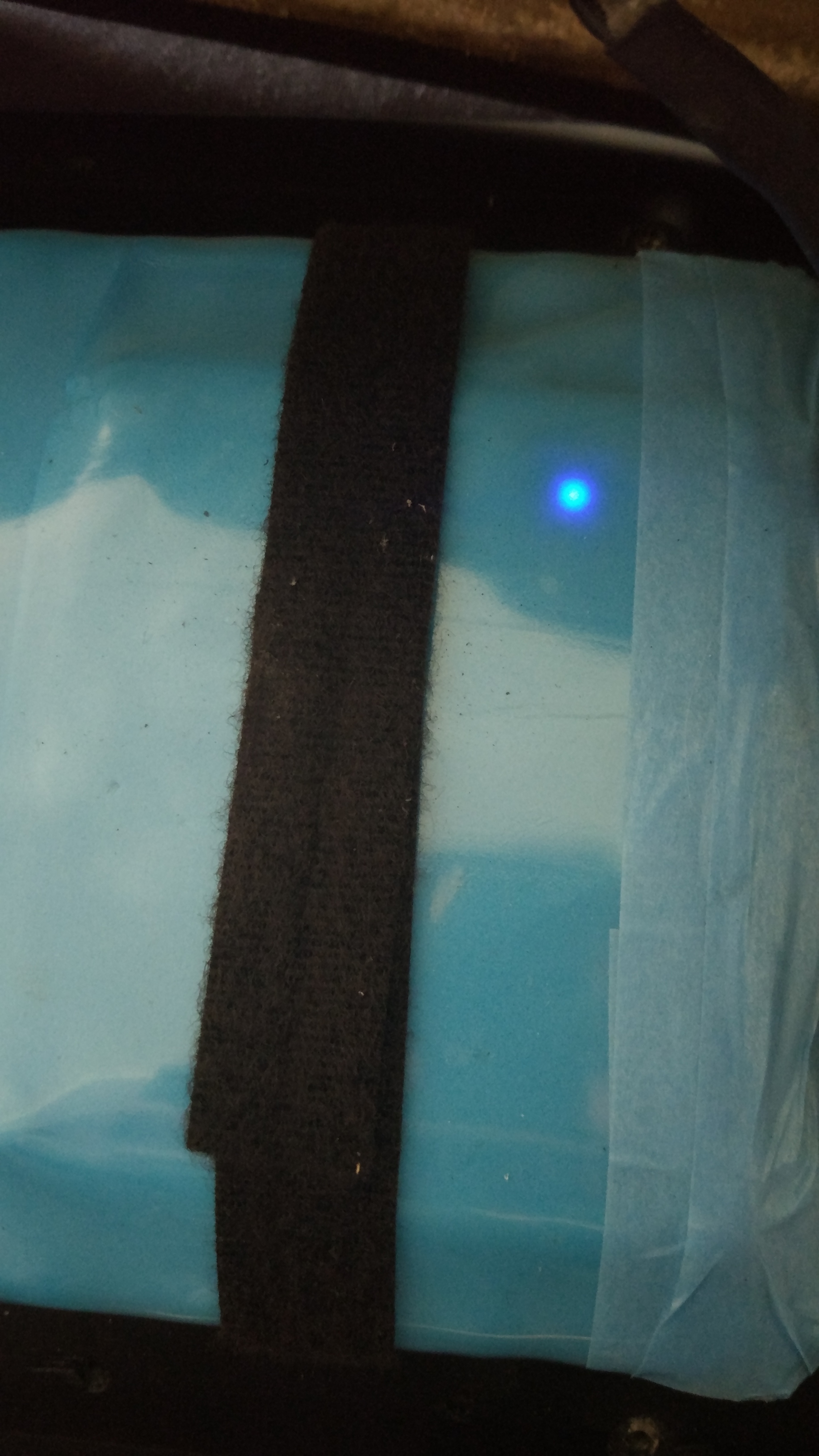

Yeh is the bms. I open the enclosure and basically my bms has leds to show when the single cells reached 42V…
As you can see one of the led is on. Basic Aly it has led to show when the single cells reach 42V.

Forget all that have been said. First check the cells voltages if they really differ from each other. Maybe the BMS is defective so that it thinks one cell is already fully charged but isn’t in reality. If one cell is really fully charged already then leave the pack connected at the charger for a couple of hours because now the BMS needs to balance the cells which can take a long time when the balance bleed current is only 50ma or somewhere near. The BMS shouldn’t balance during discharge and it also can’t do that when the bleed current is so tiny and we only brake for a couple of seconds.
When you charged the pack to less voltage then stupid BMS can’t balance the cells because they only start to balance when the cells are fully charged.
If the cells voltages really differ that much from another then there also must be a reason which you should try to find out. Maybe one cell in a parallel pack lost a nickel strip.
