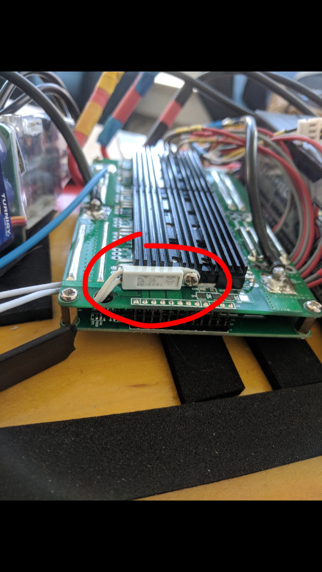

Can anyone tell me if these pins are supposed to be shorted?
Respectively, what this part is used for?
thats the temp sensor
Thanks! Do you know how it works?
Is it supposed to create a short when the temperature-cutoff of the BMS is NOT reached? (and open when it is reached?)
Ok thanks!
It’s probably just a thermistor, always a closed circuit that varies resistance depending on temperature.
