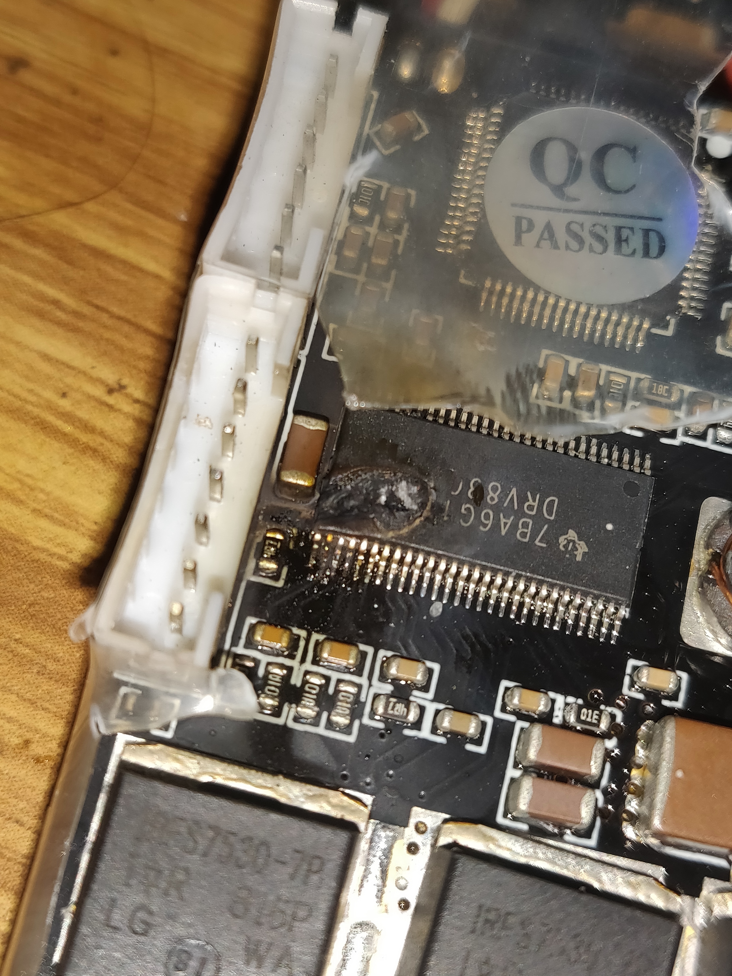

Okay so I was just randomly playing with my board, which is currently in a state of repair. Was just spinning the motors up, one of them would spin some times and wouldn’t other times. Then a loud pop with some smoke, and she’s fucked. Can anyone help me figure out what I did wrong? This is my first time playing with VESCs, so I had battery amps set to like 30A
I know I’ve blown the DRV, just wondered if anyone had any idea of why it happened so I know to not do it again
If you were running it on the bench you may have exceeded the 60k erpm limit…
Did you go full throttle without any load? What’s your battery and motor values?
It’s a clone and when you look at the placement of the FETs, it’s not made very well. The two FETs (lower right corner are nearly touching each other). It would not surprise me if this is not the only issue.

Yeah I did, that’s probably what did it.
12s5p 30Q with SK8 6364 190kV on FOC
Motor Max 50A Motor Min -30A
Batt Max 30A Batt Min Regen -2A
I can now see how it seems pretty clear this is my fuck up. I just want to be able to learn as much as possible to help in the future
Never blast it on the bench… and 12s foc is a very risky business…

And -2A on the battery min will not give you any brakes. This value defines the strength of the brakes at speed. The motor min becomes more dominant at slower speeds! It doesn’t help to use high motor regen values and low Batt Min Regen values. The braking energy needs to be stored somewhere. If you close that door, you will not have an brakes when you need them.
12S FOC is no issue if you use proper hardware. Clone HW 4.12 ESCs can’t handle FOC at 12S really well. Chances are high that you fry the system.

Run it in BLDC if you use HW 4.12 Assuming you use a 12s5p pack from 15A rated original Samsung cells:
Motor max 55 to 60A Motor max Regen: - 30A Battery Max 35A (each ESC sucks 35 A, which results in 70A for the Battery). Battery max Regen. -25A to -30A (about same as motor regen will result in more linear brakes)
The battery will not the high currents for a long time when you brake. These are very short spikes only.
That is not an over erpm issue. That set up should not exceed the limit.
That is a faulty vesc. Get in touch with them. They are good people and will help you out.
