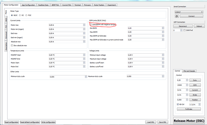

Is it possible that the vesc went over the set max erpm limit I set in bldc tool?
Multiply your kv by your nominal voltage and if you are under 8600rpm you should be fine. I like a little more buffer for the occasional dh session but it is only a real danger if you release the throttle and let the motor spin freely beyond the maximum voltage/rpm

@chaka @devin I keep my ERPM pretty low and my Real-world (and anecdotal) experience has been that if I approach or exceed that limit and apply throttle, I just continue to coast. I can hear VESC engaging but it never presents a “braking” effect if I’m beyond ERPM and apply more throttle. I forget which parameter it is in BLDC Tool, but I believe that this behavior is the default.
@treenutter Thats the parameter. When it is disabled then it simply shuts off the VESC. When it is enabled it brakes when it exceeds the MAX ERPM.
