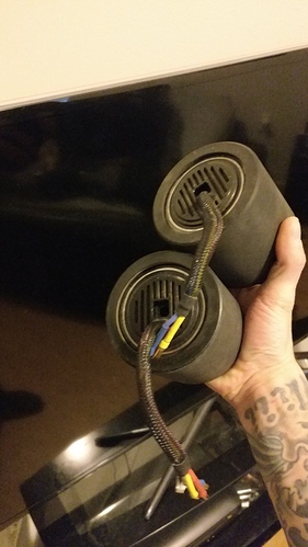

i built a 12s dual 6374 board waiting on my Raptor 2 im not sure which board will accelerate faster but i do know my DIY board can do 40+mph and i used to think the raptor 30mph top speed was too fast lol.
Ill let you know whats faster once my Raptor 2 magically appears at my home but i cant see the Raptor being faster then my current set up.
