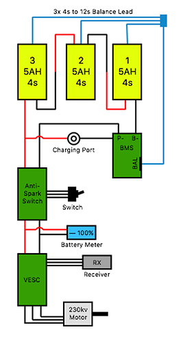

say i have this diagram right:
in places like the battery meter how do I make split the cable like that? is it with this?
and the red cable thats splits for the charging port. what do i use? basically how do I make 1 cable 2.
and say its dual motor, do i feed both cables into the master vesc, or do i split each with the image before?
and as for the charging port, how does this connect to the bms? do i cut the white part and solder it? cause i didnt see a balance port on the bms for charging. did i just miss it? i’ve been searching for a long while, but it seems like most people just kinda know these things, and i feel like im just out of the loop, ik that i need to research, but im just reading the same posts over and over, so yea… did i get it right?
You cant use 12S on VESC with 230kv motor, you are exceeding eRPM limit! You can limit that, but you will never reach the motor’s full potential…
yea thats a mistake, its 2 170 kv motors (hopefully)
