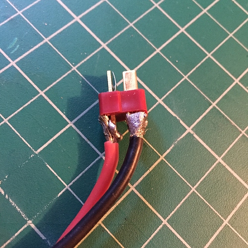

Also, @lox897, I admire your efforts to get better at soldering! Don’t be discouraged if they come out badly while you’re learning. Here’s a pic of my first terrible attempt at soldering a dean’s connection. I keep it on my bench to remember what not to do… It’s a cold join, I didn’t tin the wire, used a small tip at a low temp, and no flux. As you can see, the result is crap. But the failure helped me to learn!
